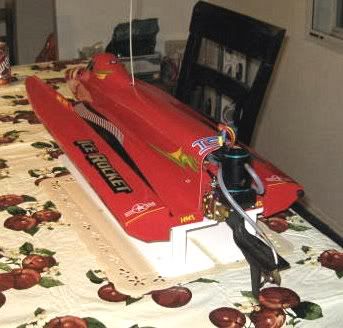

                          This thread is responsable for me needing to do a TS2.... I saw Darin doing one and needed one to. I finally finished or should I say refinished it. This time I think she is right. First time around I had to much weight forward and could not adjust it and the servo was not strong enough and I did not like how the stearing was set up. Took care of all of that and also put a better jack plate from the capt. Thanks to a few people on this forum for info and parts, I finally finished her again. I will be giving her a test tomarrow with a 1740-3..we will see what happens

                            re :
                            Good luck & bon voyage, Joey. With a little dialing in, this boat is FUN ! Let us know how she does
