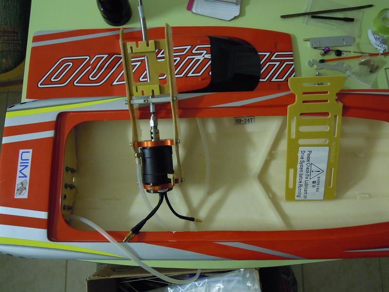

      001.JPG002.JPG003.JPG004.JPGWell here is some pic of my set up turngy 120 speedo going to try a 440 prop first and 150 cable .... see what happends.....Aloha from Hawaii

        IMG_2311.jpg heres a pic of the drive hardware
