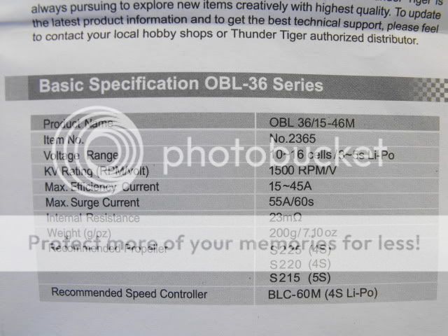

          not to jack this thread
          but this is the outrunner he was talking about that came in my Outlaw OBL
          its for sale
          • ray schrauwen
            • 9471
            #35
            MAnual shows that it was to run on a 225 prop stock.
            Kv was 1500, not sure on stock battery voltage requirements but, 4S to 5S sounds right. Remember it only has a Seaking 60 amp esc so, don't push it.
            I'll give you a whoppping $20 for that motor shipped to my door or $20 just for the cooler if it can be removed as a separate unit?
            The motor i think is only rated @ 50 amps.

              It says upto 5s on this motor, its never been ran Ray
              I remember Darla at RCU getting jacked around with her boat
              someone on youtube has the OBL running 5s with a CF45 prop and it looks real good
              so on 5s it could get 800-1000watts
              I think in a 26-29 mono it could do very well
