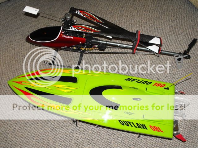

Ran my Sniper today, stock set up, with full Eagle Tree set up. My RPM was off since I did not know how many poles this small ourtrunner has? (you need to enter the value since I am using the brushless motor sensor).
Second question, what motor, brushless outrunner, I assume due to the nice water cooled mount, would you recommend as an upgrade. I already have a bunch of spae Seaking waterproof ESC's that go all the way to 180 AMps?Comment

I personally think keeping the rpm/kv to under 30,000 is probably the best route to take. IE upgrading the motor to higher KV. Rather than throwing a 4s in there. JMO. It might be worth just seeing what a 4S will; but for running with a little more speed, a higher KV motor for sure.HPR115 x2 ,Dark Horse Shovel, Delta Force CyberStorm, Delta Force Sniper 23-RTR:
well I have 6 2200mah 3s packs and 4 2200mah 4s packs so I could have a very fun day with one of these DF23's!.NAMBA20...Caterpillar UL-1, P-Spec OM29, P-Mono DF33, P-Spec JAE, Aussie 33" Hydro-LSH, Sprintcat CC2028 on 8s, PT SS45 Q Hydro, PS295 UL-1 power, OSE Brothers Outlaw QMono 4-sale, Rio 51z CC2028 on 8s
Here is the upgrade motor I have installed and will test today:I personally think keeping the rpm/kv to under 30,000 is probably the best route to take. IE upgrading the motor to higher KV. Rather than throwing a 4s in there. JMO. It might be worth just seeing what a 4S will; but for running with a little more speed, a higher KV motor for sure.
http://www.hobbyking.com/hobbyking/s...idProduct=8594Comment
Be warned, that TT boat may smoke the motor & ESC first run.
Don't see how they expected a 37mm outrunner to power a 40" boat????
Nice looking boat though, lots of upgrade possible.

but post me an outrunner you think would make this hull fly.NAMBA20...Caterpillar UL-1, P-Spec OM29, P-Mono DF33, P-Spec JAE, Aussie 33" Hydro-LSH, Sprintcat CC2028 on 8s, PT SS45 Q Hydro, PS295 UL-1 power, OSE Brothers Outlaw QMono 4-sale, Rio 51z CC2028 on 8s
Its a good motor for a 25"-29" hull but, not 40", Jeese!
A Turnigy HK 4030 1400KV will get it moving well but, I am going to use a Leopard 5692 1092 KV in my 40" mono build. Just have to start it....
I am going to try the Turnigy 880Kv motor or the 1100Kv one on 7S2P also, to see how they work.
They are very nice motors for the money.
