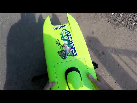

          Miss Geico 29v3 hits 75mph w/Veles motor!!
          I'm playing it safe with the Veles until the upgraded shaft comes in so I decided to get the Misses out this afternoon after work, I loosened her up a bit and she clocked at 75.12 mph (121kmh). I had to make it short n' sweet because a huge thunderstorm popped up. One more adjustment and I believe I'll have her where she needs to be. Then I'll put a new fresh motor in her and I should pick up a little more mph. This motor has been abused on more than 15 runs and seen some pretty high temps in a couple of those test, so I know it is bound to be getting a tad weak cause she smells just a little...lol. https://www.youtube.com/watch?v=7W8SmhZDTak

              Miss Geico v3 hits 78mph (126kmh)!
              First run of the Spring with my stock Miss Geico 29v3 with the updated Dynamite 3831 motor and she didn't do too bad. I hate when I start running at the wrong angle and have to let out early due to the bank and fisherman coming very quickly (lol). The boat has more in it and my next run I will be hoping to be closer to 80mph. Video is below.

                Miss Geico hits 81mph stock w/3831
                Thread updated with my new top speed run of 81mph.

                        83.5MPH (134KMH) MISS Geico 29 v3
                        STILL STOCK! NEW BEST SPEED! 83.5mph by the gps and 83.26mph (134kmh) by the logger. The boat held 5 steps of 83mph by the logger then It finally blew over. Not bad for a RTR boat on stock electronics running 6s..... Thanks for watching! https://www.youtube.com/watch?v=mrxX...ature=youtu.be
