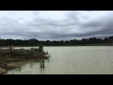

    This I think deserved its own thread. Backstory: I've been building cats for a little while and I decided I wanted a boat that could be run in water that's not glass smooth. I decided to build a mono. I figured 32-34" would be good enough for what I run in. I had initially thought I'd build a 70mph saw mono and then back it down to 50ish for running on the river and when we go to Panama City for vacation....we always take a pontoon boat out in the bay. Thought that might be fun. Well.....I always get carried away with things and decided to see just how fast I could make a mono go. Reliably. Well here's where I'm at so far....

    Killer!

      BTW... What are the specs of that mono?
      Thats kind of insane... What are you doing to make the boat so stable?

          Way to go

            Legend. I guess now you've smashed the 80 goal you gonna look for the ton?

              Well all of that is top secret. Just kidding. It's a 1600kv 2260 lehner. 8s, m447 prop I sharpened and balanced, 34" Keith Bradley boats mono hull. I dunno on the stable thing. I think it's a combination of a low pitch prop, the way I detailed the bottom of the rudder and fairly large trim tabs. Check out my build thread. I keep nothing secret really.

                Thanks guys. Honestly I think I'm about done. I don't want to push my luck. I am getting Dasboata to do me up a prop and maybe I'll get 93 or so but that's about all I think I'm gonna push it. I'd like to hit 100 but that extra 10mph ain't gonna be easy. I did this today in windy conditions but oddly the water was quite tame. In a little chop it goes faster. I like the fact that I don't have to pay much attention to water and wind conditions to go fast with this boat. My cats, if it's a little windy...forget it. Good stuff! I'm starting to like monos!

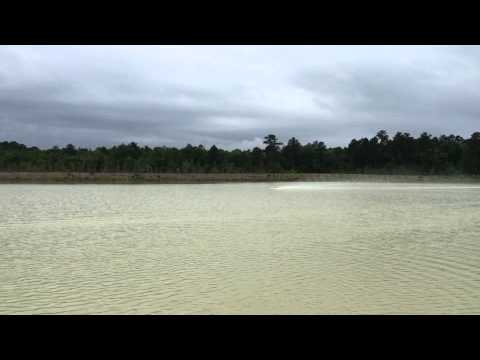

                      Here's a backup pass right after. I'm not about a one pass wonder lol

                        I'm a little bummed. Here I am, working hard to get this thing to go as fast as I can and two people give me a thumbs down on my YouTube video of the 90mph pass. Why? I don't get it, maybe it's jealousy? Hating? I dunno. Some people are just no good I guess.

                            Nice job Travis! Boat runs real nice.
