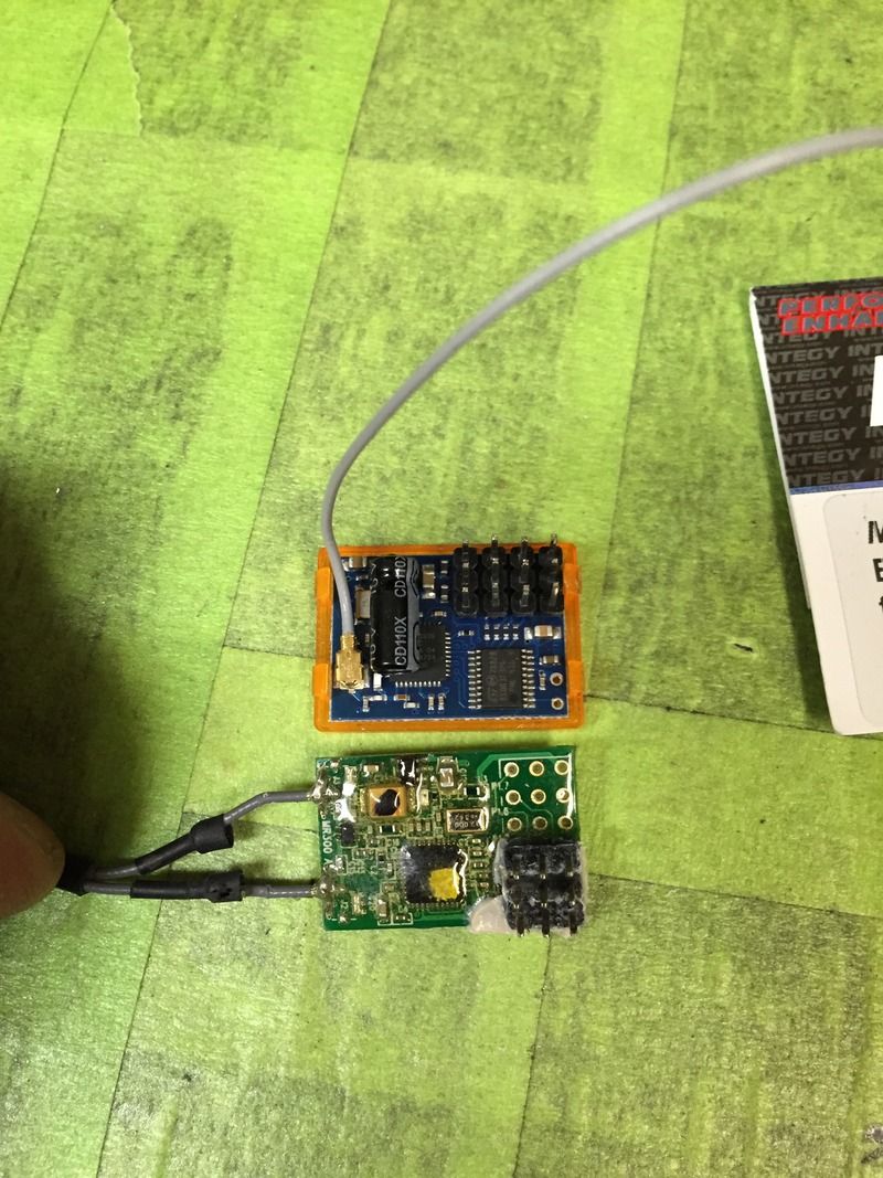

          I have one in my mini Rivercat and my sons hydro. It seems to work just as far, has a shorter antenna and only one antenna. I'm really disappointed in the Spektrum ones here lately. That's three in a week in two different boats that has failed on me.

            I have been having issues with my twin mono with steerable drives. Just a long range thing but have noticed it is happening when I turn( didn't someone else have this issue). So because of the drives I put a GOOD (crawler)servo in and upon looking things up, I found that sucker draws 5amps to hold/lock. So I put a plug in 'glitch buster' on and it helped considerably, but not gone. So I picked up some caps today to throw in and try as most BECs do not do 5amps plus whatever it takes to run Rx/ESC.
            So after all that, any resemblance Travis?
              Yep. As soon as I would turn it around it would drop the steering on me. Not every time. When I swapped receivers it didn't do it again.

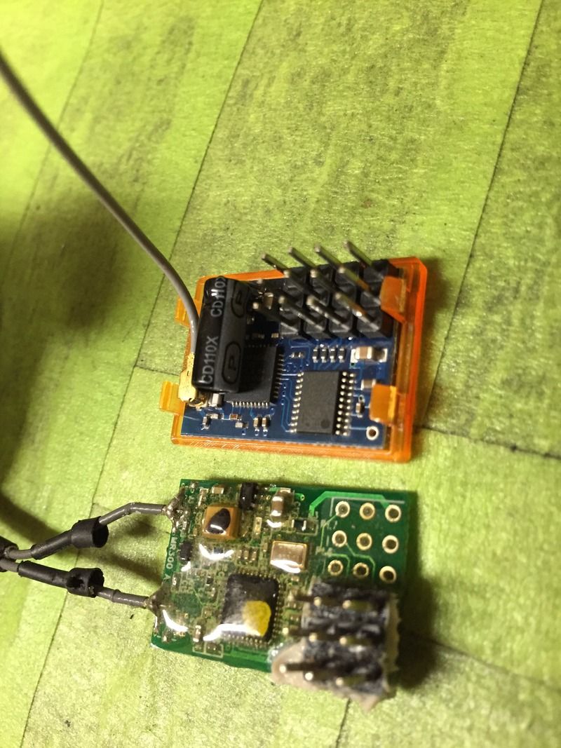

                It is odd then because aren't those Rx's a direct knock off?
                  #23
                  No they aren't even close on the inside. The orange ones have a cap installed on the board. Spektrum do not. I'll take some comparison pics.
                    #24
                    Couple pics for you. Of course the double antenna one is Spektrum.
                      #25
