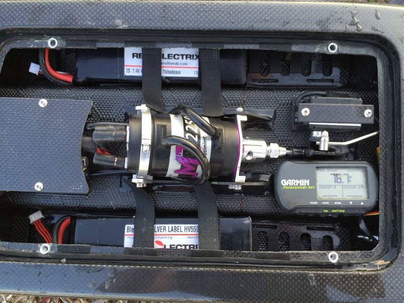

    Very first pass. M445 prop. 5s.

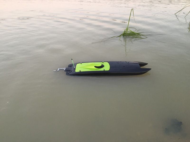

    Sitting pretty.
    Prop change. Still 5s. Not too bad I think.

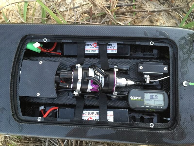

    Battery change. 6s. No other changes.
    Close up lol

        Thanks! For comparison the fastest my other ricercat went was 83.3 on 6s with a 1/2" shorter, razor sharp rudder.

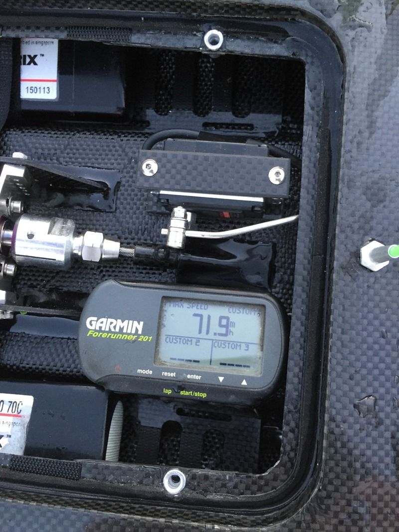

                            Didn't have very much good luck. The boat kept cutting out on me far away. Instead of looking at the obvious I was troubleshooting other stuff. The remote batteries were down to 5v so it's time for new ones. I went to the store and recharged my batteries. Headed back out. I did get a clean pass on 5s and it went 74.5mph so that's a gain. Report back later. I did get videos too.
                              Second trip was more productive. Little bit of a story to my woes today. Thoight it kept kupping up because the batts were very low in my remote. Not the problem as i put new ones in. Still kept losingbtge steering servo. Wth? Soni brought one of those orange off name receivers. That was the issue. Mr200's are letting me down left and right. Ugh. Im uploading videos right now. But for now heres gps shots of my most productive passes.
                              This is 5s. Thays right, 5s. Not too shabby.

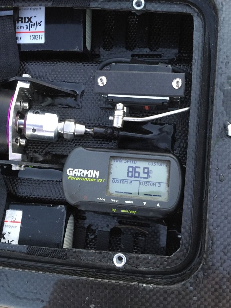

                              Heres 6s, no complaints here!
                              And i had to change the short rudder back to the long one. It woukd not stay on the water. The short rudder was worth about 4mph on 5s during my testing. I think between the extra drag and the prop just being too hard to turn any faster, thats why it didnt pick up at least 10mph like it should. Thats ok. Ive got a few things to worknon and ill get there. 7s....
