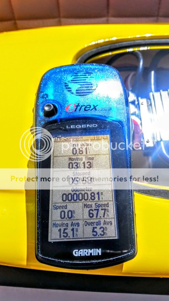

    New best this morning! It started chine walking just a tiny bit at WOT so I lowered the stinger 1/4 turn. That didn't help much so I turned the trim tabs down 1/4 turn and she was solid as a rock after that. Temps are good! Everything is in the 80s and the motor just bumped 90. I think it's time to see what 6s will do.

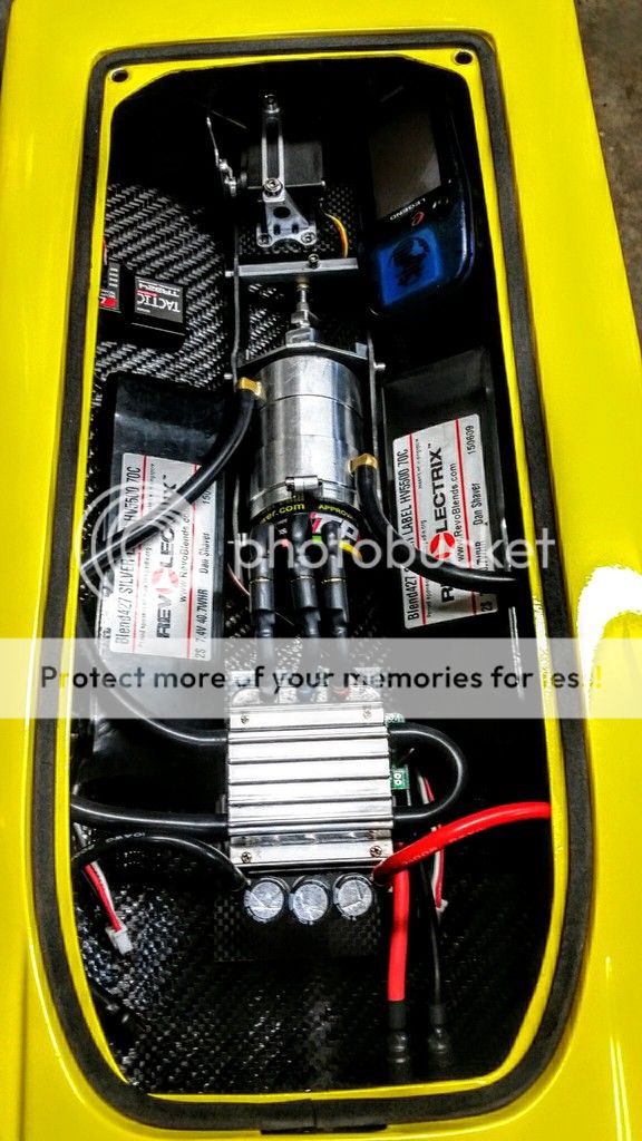

          I just wanted to say that when I was first running my Pursuit, I ran a Leopard 4082 1600kv on 6S and I was getting chine walk, top speed was 60mph. I made hull adjustment first, but later I put the batteries in the center and the ESC on the left side to counter the torque roll. This allowed me to go neutral on most of the hull settings to increased my speed to 65 mph with that setup.
          It worked perfectly, I honestly don't own a more balanced boat than my Pursuit with this configuration, it will hit 70+ mph on Octura x642 prop, SSS 2000kv motor on 6S.
          I've attached a pic below, I use two 3S 5000mAh batteries places in the battery bag in the front, connected to the hull by Velcro for low center of gravity. I use a carbon battery holder on the left side to hold my ESC, BEC-battery, receiver, etc.

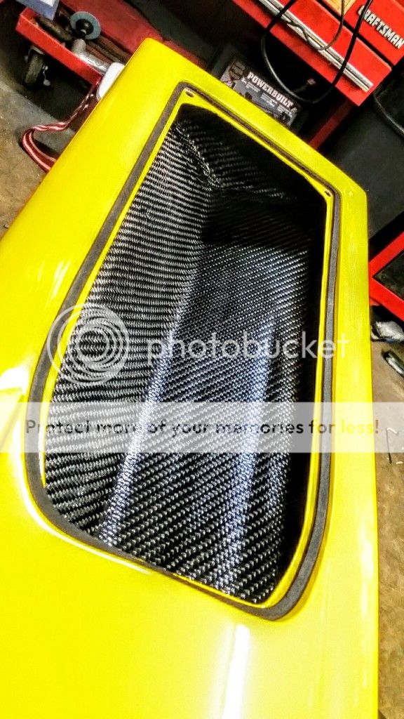

                  Got the inlay done last night. She's strong!

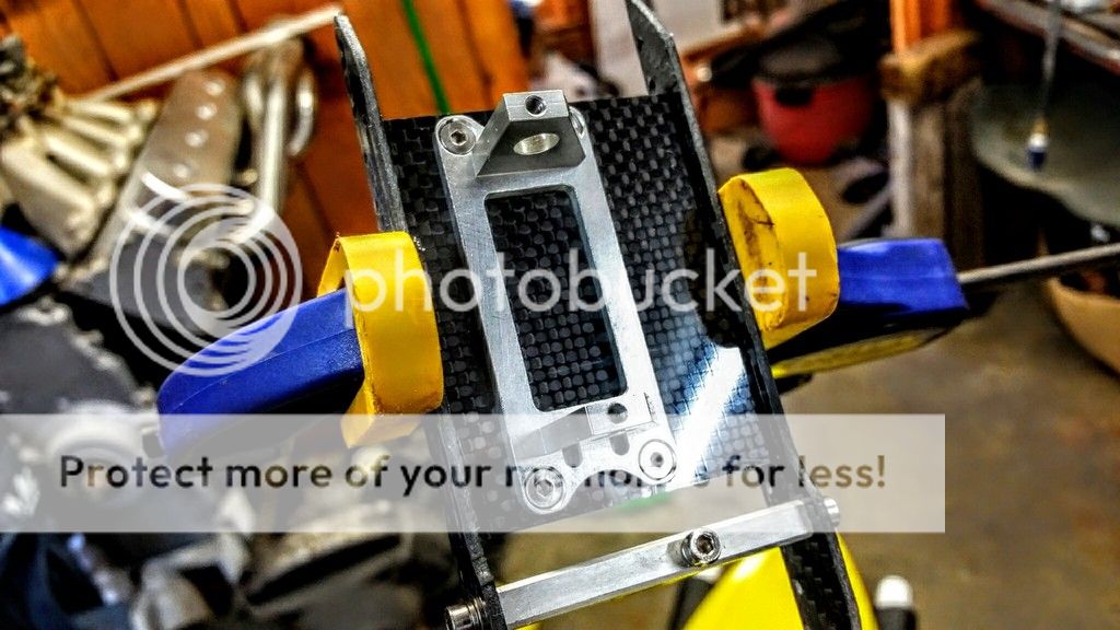

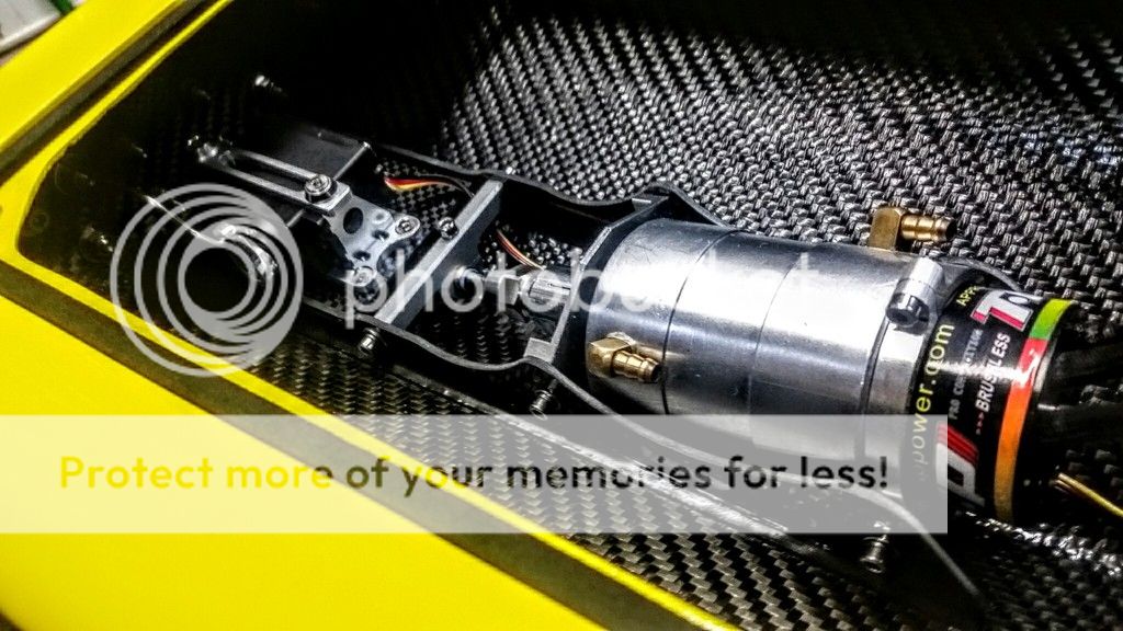

                    Back at it today! Gluing everything in. Man, that's a lot of work...
                    Made a new servo mount to get rid of the sloppy stock style.

                            What type of canopy gasket did you use?
                            Shouldn't the seam be at the transom? I get it, front = less water infiltration
