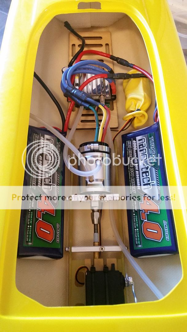

    Another happy Pursuit owner checking in! Nothing special, just wanted to show her off and say thank you to the members of OSE. The "search button" is your friend with this boat. Tons of good info! Got all the little issues ironed out before it hit the water. She did great on the maiden voyage(in rough water). Fun boat! Thanks guys!!!
    Specs:
    Stock 1620kv "SSS" motor
    T-180 ESC
    Stock prop(42mm?)
    COG 27%
    Two 2S 4000mah Nano Tech batteries(4S)
    More to come!!!
    Pursuit: T-180, TP 4060/1620kv. Genesis: T-180, GoolRC 2000kv. UL-1: Bone stock. MHZ Tsunami: Full tilt SAW project!

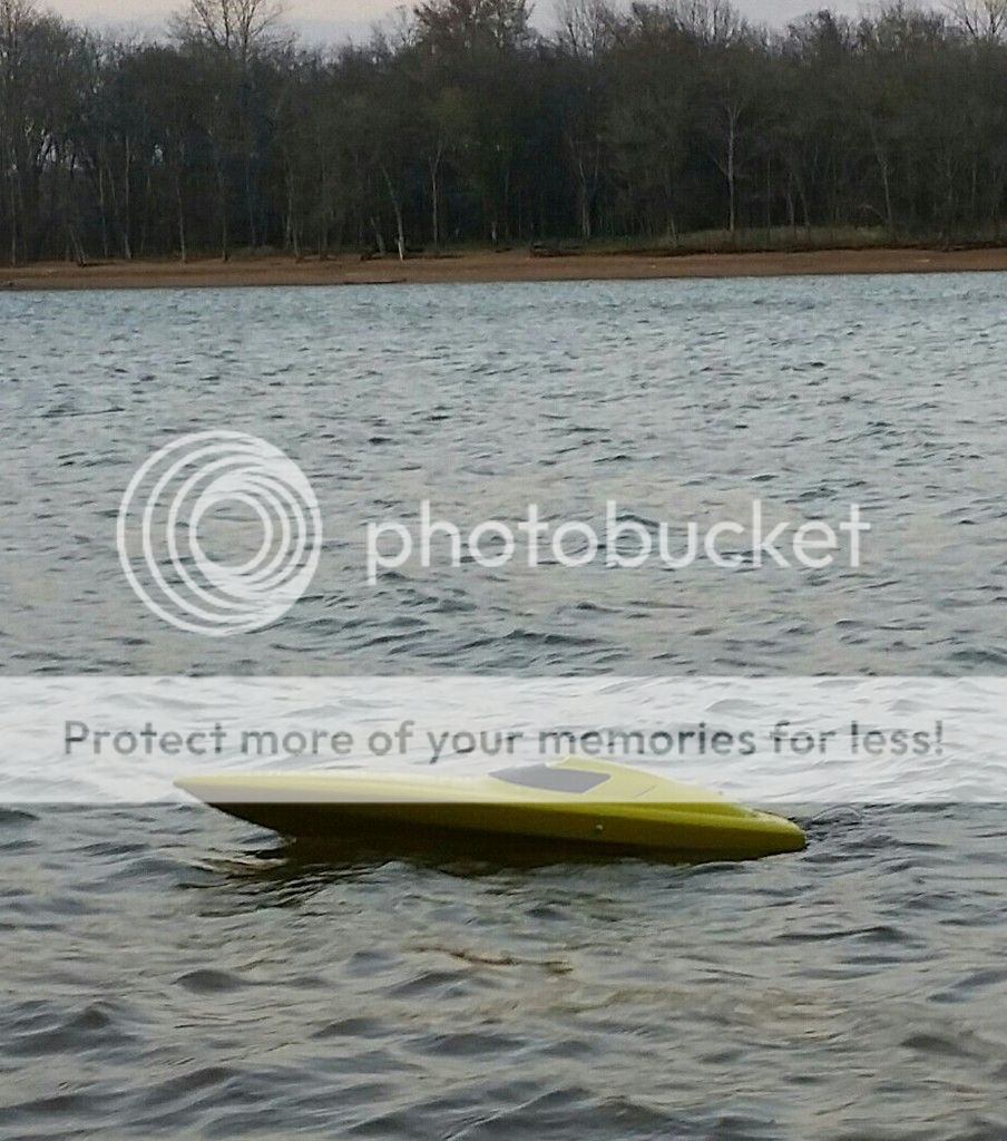

        Been working on her and getting in lots of runs. Upgraded to whole cooling system, one piece drive shaft and put on a S/B M445 prop. It looked a bit faster than with the stock prop(33 mph) but I threw in the GPS today and was surprised with 41.3 MPH! I really need to get a better GPS as I'm using a big one for car use and it threw the weight waaay off. That ended up in a flip... Pulled it out and it was running great again(faster?). Still, 8+ MPH with just a prop swap. Everything came in under 100* after running the packs down to cutoff. Fun stuff! Back to work now...
          The good news is you are no where near the top end for this boat and you have a lot more to go. I have raced this boat 4s and with a bigger prop you should easily get into the low to mid-50's without pushing it much. So lot's more speed to be had without pushing the limits. My version of this boat tended to run wet (lot's of hull in the water). If you see the heat going up, try moving the cog back a bit or lifting the tabs up. Have fun!!!!

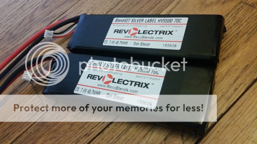

                Got these bad boys in. Pretty excited about this!
                  I wish i could get some of those... But i'm not sure i can get them in Canada.
                    Specs:
                    T-180 ESC
                    Stock prop(42mm?)
                    COG 27%
                    More to come!!!
                    On the first picture, i would invert the in and out on the motor water jacket... Bring water from the bottom to the top to avoid air in the water jacket. just my two cents!
