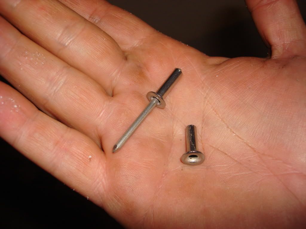

        pop rivet? water outlet?
        pop rivet is a very popular rivet..you can find in aluminum or stainless steel..

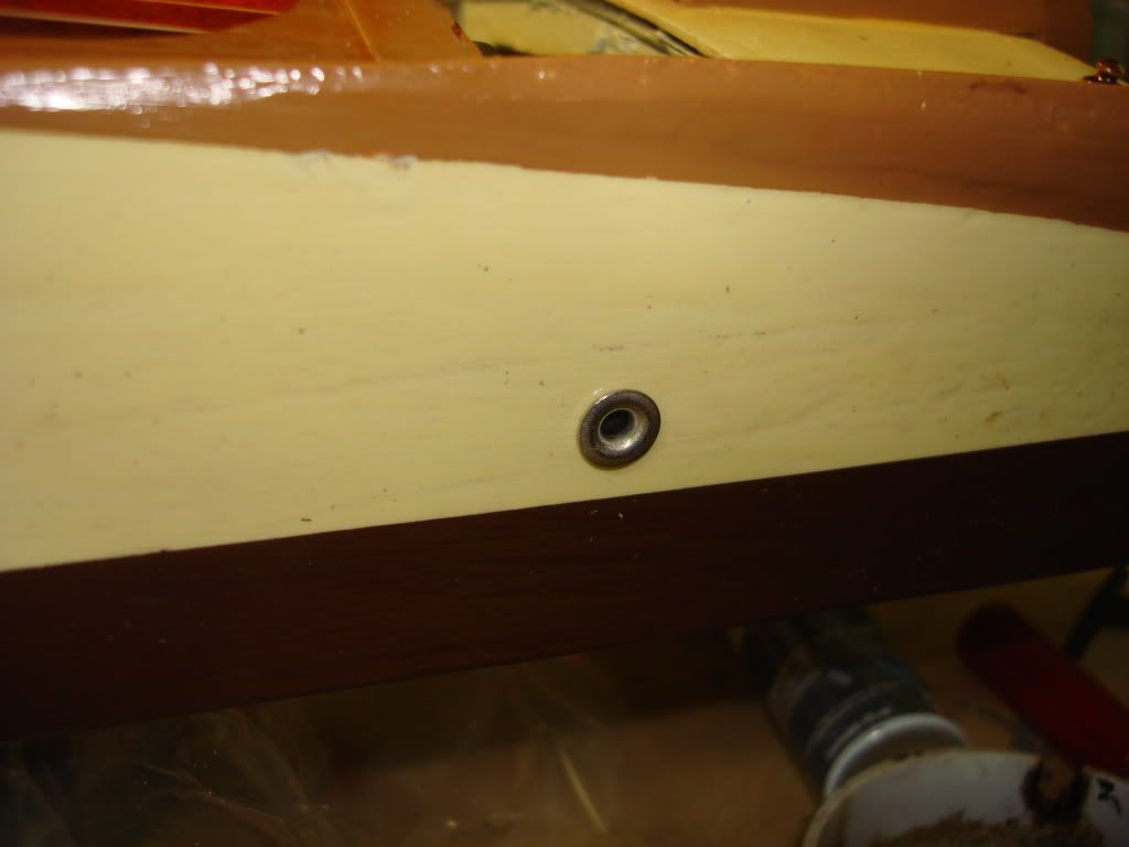

        water outlet is out of the water cooling system of motor / esc or Bilge pump ... remove the inside of the rivet, just make a hole in the side of the hull above the water line and connect the hose in the rivet ..
        in this chris craft i use for a bilge pump..

              Jim,
              Excuse my ignorance, but what is a "dome shaped Aluminum " ?
              from here comes the pop idea...
              cheers!!

                  If you look at the picture you see that there is actually a dome and the rivit hear is thicker near the opening. Hope this helps
