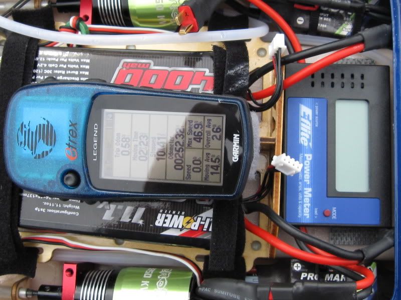

                          • 9488
                          #192
                          Originally posted by NitroVal
                          Yup, it say only 3S batteries.
                          I ran again today with the x442 props. Pretty impressive, 8.6mph gain. New best 43.6mph with nothing but props. They may be a little big though. I think the amp draw would be excessive with 4S batteries. The motors and ESC were warm, but the motor wires were hot. Im gonna run again tomorrow and take my temp gun to make sure. Anyone know how hot is too hot?
                          This helps my decide that the OSE calculator is pretty dead on, even though its for single motors and this boat runs dual motors. The calculator put my top speed at 42mph
                          Do you have a shot of a gps with your mph?

                              #194
