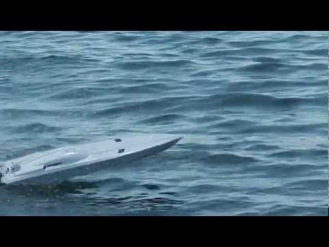

                    I changed out the traxxas electronics for a turnigy 180 esc and a castle 1515 1yf can with one of Steve's cooling jackets. I'm using a 445 B&S prop. I have to use 2 x 4s 5000's in parallel to keep it running cool. It puffs the batteries if I use just one. Getting mid 40's out of it and happy with that. It's great for playing in the waves when I can't run my cat. Chine isn't an issue at these lower speeds. I'd love to see a vid when you hit 60 :)
                    The video says 442 prop, but it's a 445.

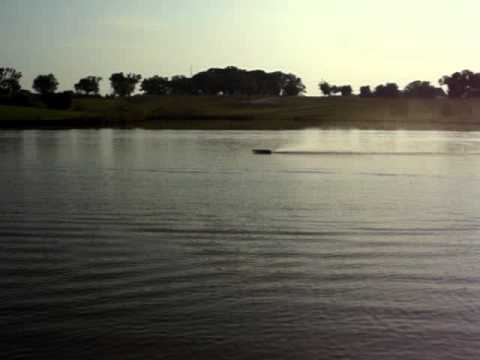

                      here is the 63 run you can look at my channel for the faster runs

                        wow... what is your set up??? I haven't been able to get mine to run like that with out chine walk... only once really and it was the only time I had been on water that was dead calm... but I forgot my GPS that day
                        • MAMBA2200
                          I need a scooby snack
                          • Jul 2012
                          • 1196
                          batteries half way back strut up 2mm trim tabs level seaking 180 castle cc1515 2200kv motor on 6s
