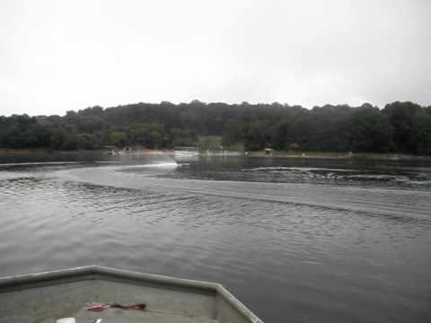

                              Here is a very brief clip of the boat running with the new motor config, 4 changemaker trim tabs, and 2 8400 packs. I did not have it fully dialed in on the trim. I blew a solder, so it cut the day short. As you can see, she is hauling and is pretty stable.

                                Sweet!
