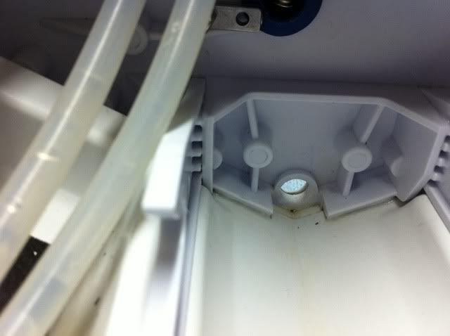

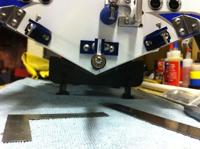

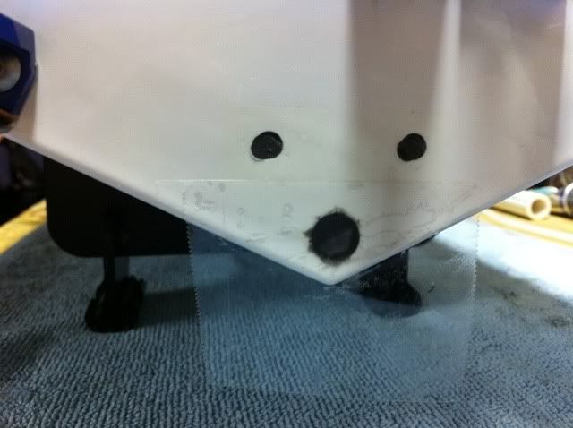

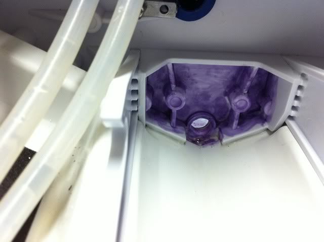

    Screw it, Im going to slightly relocate the strut up a hair and towards the starboard side near 1/8". This should help both the torque roll and chinewalk issues from all the setups I have been reading about.
    primed & cleaned
    2 part epoxy that bonds to plastics really well PC-7 laid out
    drilled out the stock stinger bracket holes so I could fill them in with no air trapped because they will need to be moved over as well.

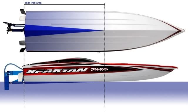

            The Spartan also has a deeper v than most of the good v hulls that we all know & use. Its around 3 degrees different + theirs no ride pad, Any thoughts on this re chine walk. Thanks Martin.

              My other idea I had was to take the tip of the vee off the hull and make it about 1/4 wide flat. Starting about mid ways up the hull towards the transom. That would help wouldn't it by giving a ride pad?

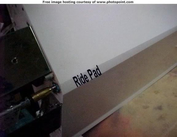

                    This article is what gave me the idea.
                    "A sharp keel cuts through the water and will limit lift. Even sharp keels have limitations. Ride pads integrated into the hull bottom have to be used once you hit speeds in the upper 50-60 MPH range. At this kind of speed even a sharp strake less keel can provide enough lift to cause chine walking. Trim tabs can help but your really fighting against the physics involved and mother nature will win this one! "
                    Bellow, a picture of a ride pad on Ron Frank's boat"

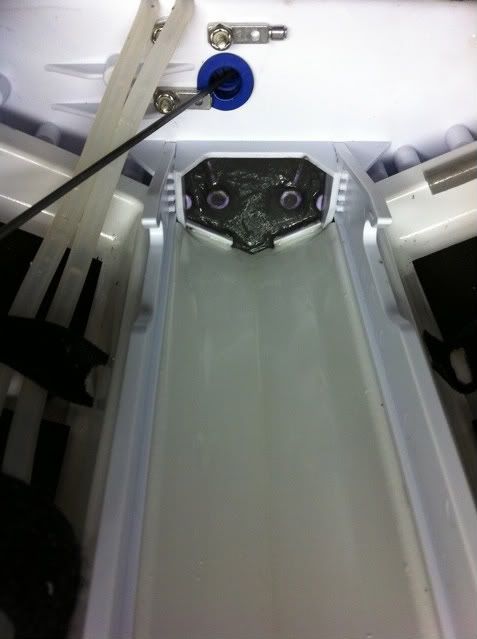

                        This is how it's looking so far. I'm probably going to leave the stuffing tube hole the size of the tube and seal it temporarily for testing. If it works good I'll make the hole bigger to put the rubber gromet back in so the tray can be removed easier.

                            Hope it works, Ive heard mixed up things about moving the strut over off center of the hull vee.
                            I guess if it dosent work I can make the hole bigger with a file back towards the center of the hull and put the rubber grommet back in, but the strut will still be slightly higher overall.
                            Ive also heard that moving it up will cause problems because not as much water will be getting to the prop. im getting wore out with this thing

                              PS Judging by the diagram of the ride pad, it looks as though the Spartan might benefit from another set of trim tabs on the inside mounts.
