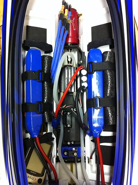

    After I got home and watched the videos it seems to be when the boat is spooling up rpms that it leans a little to the right starboard side. Then comes up on plane and then the chine walking starts. I cant seem to trim that out with the tabs. So I am thinking I will try shifting the weight a little more inside the hull. I already have been making it about 5oz heavier on the left port side placing my gps there. Now I had the idea to shift the batteries over just slightly but still in their trays. Just on their sides. I checked this in the bath tub to see if the weight does in fact make the boat a little heavier on the left port and it does. I just hope it helps counter the boat wanting to lean right.
    any ideas or thoughts, something maybe I haven't thought of yet is welcome to be brought to the table. thanks,
    justin
    Pic of what I just thought of trying.

        I shift my batteries over in most of my boats..................

                Is there room for two batteries on each side? Either one in front of the other, or make a brick by putting them in side by side (on their sides).
                I'm wondering what more weight would do for the chine walking, and also wondering if there is room to do a parallel set up for longer run times.
                I know the extra weight will make top end speeds more of a challenge, but can't help wondering what it might do for stability.
                Kevin
                • JPriami
                  N4FOX
                  • 1675
                  im not sure if you could squeeze 2 packs on one tray or not. I cant fit both may packs on one side i dont think. I'll try it after i finish my soup for you :D.
                  • JPriami
                    N4FOX
                    • 1675
                    Kevin,
                    I was able to get both packs side by side in there. But it was tight and the strap might need to be longer. You could propbally stack them too.

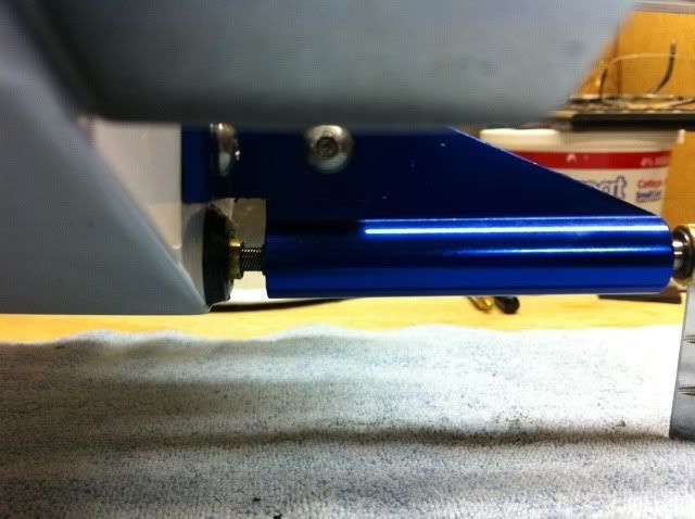

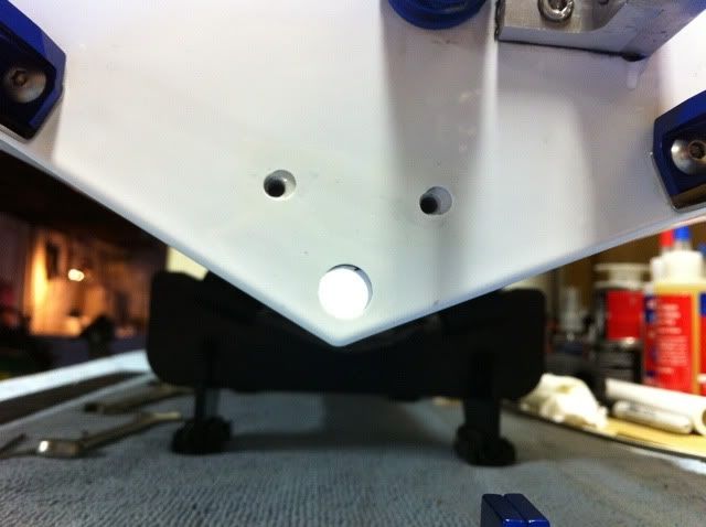

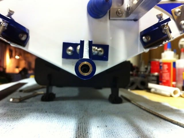

                            pics of the stock strut and hull alignment
                            • JPriami
                              N4FOX
                              • 1675
                              I was just talking to brushless55 and said this to him about the pic above.
                              "you know the more i look at that pic it begins to look like the boat was supposed to have a slight offset to the right with the strut and slightly higher and they had to re drill the holes when they glued the transom plate thats inside in because they glued it in wrong."
