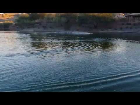

                      #280
                      testing going well..new prop and strut...
