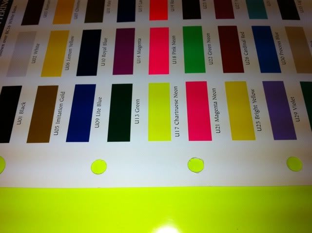

                        Miss Geico Paint match
                        Can anyone tell me if the found a touch up paint for Miss G BL?? Thanks for the help. My deck and hull at the bow cracked about one inch form thr tip of the starboard sponson. No impact and only running 5000 Mah Nimh's. Need to patch up and repaint. I love this Boat!!! THANKS

                            #223
                            I have some paint on order and should get it next week. I ordered two colors incase I have to tint it to match better. You will need a white base under the color if your doing a repair job. That's how the color gets it's extra brightness.
                            Here is a pic of the paint chips against my boat.
                            Justin
