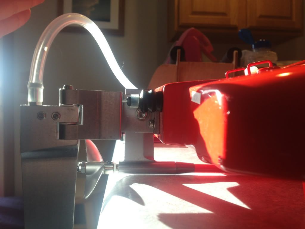

      Raise your strut up 3/16. Most guys move their packs forward cause their struts are too low and it causes the bow to lift. Adding weight in the front is just a band aid. Simple strut raise is a much better solution

        So, if I understand correctly, you're saying that the COG setting should be used to keep the bow up a tiny bit to reduce wetted hull area, while keeping less prop in the water, to minimize prop-induced bow lift while maximizing prop-induced stern lift. Sounds like a plan.
        I raised the strut. There's about 3/16" of clearance still remaining between the prop and the strut frame, so it could still go higher if I wanted to.
        Here's the boat sitting flat on the kitchen counter.
            Yup that's what I'm sayin. You actually grasp this concept I see...
            You could Probly go higher, but just go in 1/8 increments at a time. You will notice a large improvement in handling raising it
