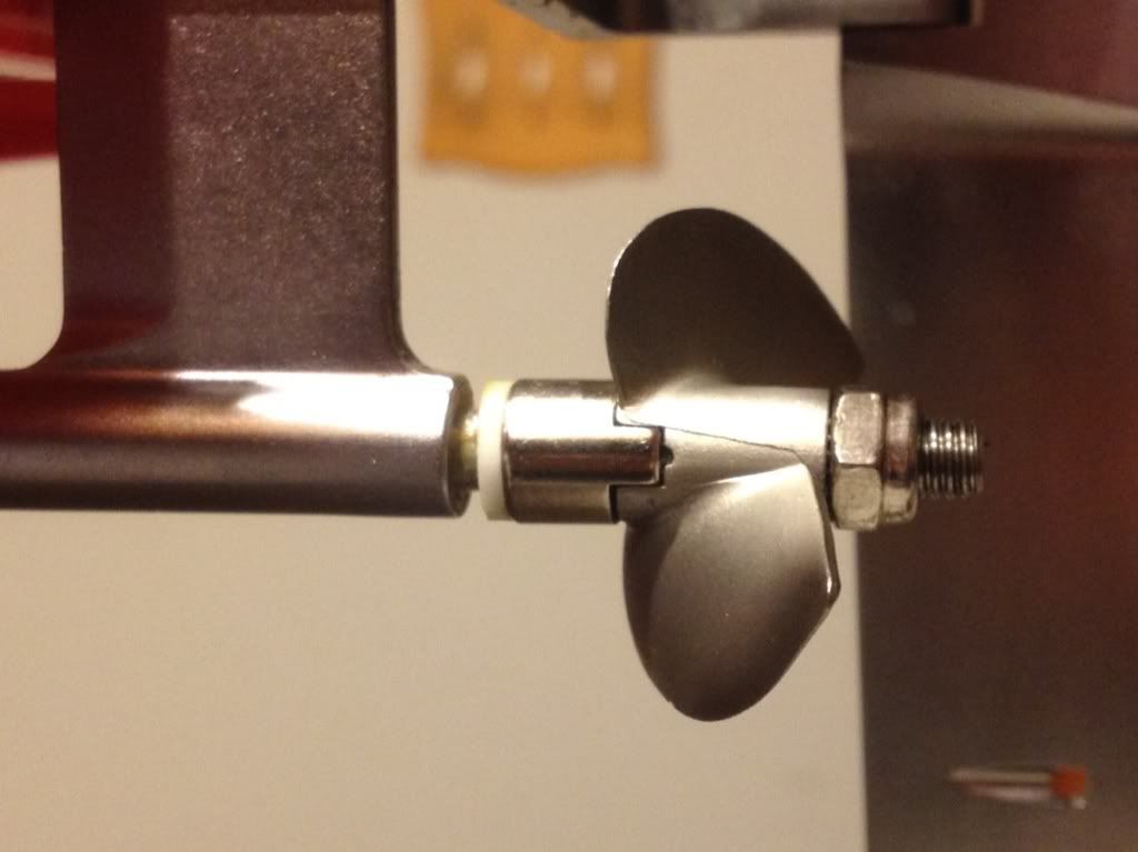

            Newbie question...
            Should the shaft have this gap? I would have thought the plastic washer would be nearly seated? Should I re-chuck the collet to close this gap or what?

              The gap should be the same as the OD of the flex shaft.
              And you do not need the washer.

                  #23
                  The flex shafts Outside Diameter is a good gap at the strut or stinger to prop dog on boats.
