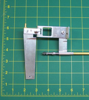

I just picked up a brand new blackjack 26 hull and hatch on flea-bay for 65 bucks. Any suggestions on the setup? I actually picked up an H/K typhoon 500 Heli outrunner motor (1800kv) and want to run it on 4s for sport. I have a turnigy 60 amp esc I think will work o.k. Just need some drive hardware and some prop advise.

lot of people use this from ose and I love it. I like running mine with out the turn fins, I filled in those holes.

Oh! LOL...and I'm sure with some decent running gear that allows you to tweak the strut depth and angle more would provide a couple more +mph...won't know until next season though with the lakes all frozen over
