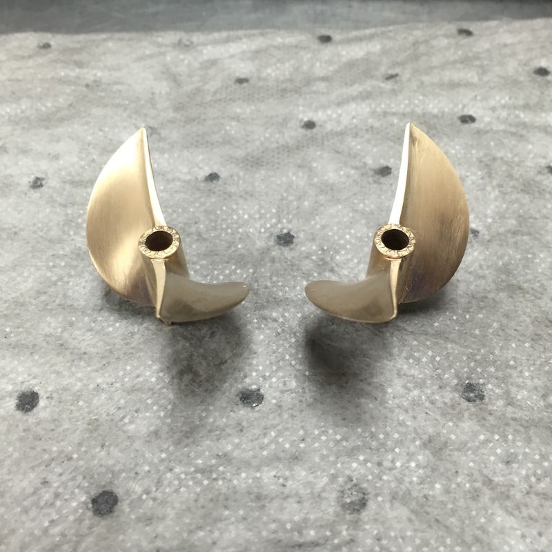

                        Quick request from any of you that have achieved over 65- 75 mph with your Zelos. I am thinking maybe I didn't sharpen the X447s enough, would it be possible for anybody to take pics of their props sharpened and balanced for comparison sake. I know I won't be able to tell the difference by pics only but its a start. I know arrover runs the X447s but any prop will do in this case.
                          #357

                            Yeaaahhh mine looks nothing like that! Will a post a photo when I get home.

                              Bench test your props after you balance them. Full throttle for 2 seconds; wont hurt a thing. Be extra cautious of the spinning props. If the drive/strut vibrates, the prop's not balanced.

                                image.jpg Unpolished Dasboata abc 1615s. 68 mph stock electronics.
