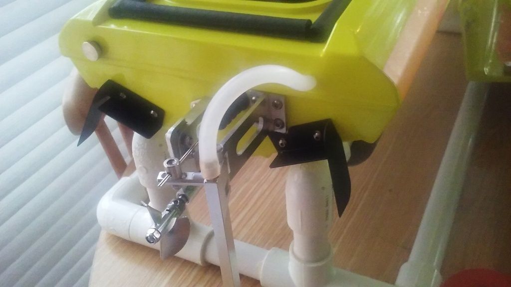

        Replaced the anemic trim tabs with the ones from the Stealthwake.
        Not a direct bolt on, had to drill new holes, but a world of a difference. They really should consider just using these.
        I did have to notch the right side, as you can see in the pic. Far better.

          ^^What prop is that?
            Yes, which prop is it ?
                Sorry for the delay,
                Its a CNC Prop, 40mm.
                The boat was considerably faster but also ran considerably hotter.
                I did not take temps but I will and report back.
