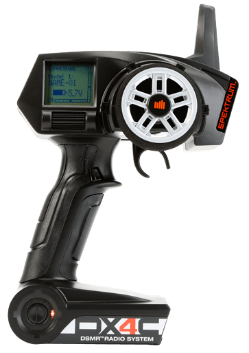

              Honestly, if you are going to run RC Boats, I'd opt for an upgraded radio system and just plan on running that in all your boats. You can get a VERY reasonably priced mulit-Model Spektrum TX for about $100.00, with 20-Model Memory and compatible with the latest Spektrum waterproof RXs (SR210, SR310, etc.)...
              Then you don't have to worry about some of these lower end supplied TXs. Those get you running, but everyone ALWAYS wants/expects more than these provide. :)

                  Using the stock radio for boats is nothing new. We've been doing this for over a year know with the Blackjack 24 and Shockwave 26, with no complaints other than a bad RX/Tx here or there; nothing abnormal. A DX2e with a 310Rx is $60 if you want more range. "Car" receivers will work in any application. The only materials that hinder the performance of 2.4 are tightly woven composites like Carbon or Kevlar. Keep in mind that water deflects 2.4 radio waves so if the antenna is to low in the hull, range will suffer.

                    Rafael, I understand what you are saying. The antenna isn't very long at all. I would say 3 to 4". This the older receiver from my DX3S. I like the radio very much. What do you think the range would be using this set up? Also since the antenna on the receiver I got with my DX3S is just a bit above the receiver would be okay to get more than 200 feet?

                            Having the DX3S available, you have several RX options that will work. Is this a recent DX3S, or have you had it awhile? I ask, because it makes a difference on what RXs will work well with it.
                            If it's OLDER, then you can always find some 2nd hand MR200s and you'll never have range concerns again. If it's newer, then the RX I posted above will work well.
                            I think the reason Pro Boat can't/doesn't provide ARR any longer is that it's simply one more stocking item. It's less expensive and more practical for them to offer these as RTR. And, it likely gets more people involved.
                            Never ideal situations, but with RTR stuff, there are always production compromises somewhere.

                              I understand everything you said. It does make sense about one more item to stock. By the way my DX3S is the older one. I will look for a MR200. I have a 4 channel in there now with the shorter antennae. It cannot go up into the antennae tube though. Do you think that will be a problem?

                                Shouldn't be, but radios are finicky. If you get the antenna as high in the hull as you can, you should be fine at reasonable ranges. I used to velocro my RXs upside down under the upper side of the hull to get the antennas out all the way. Keeps water out mostly too. :)
