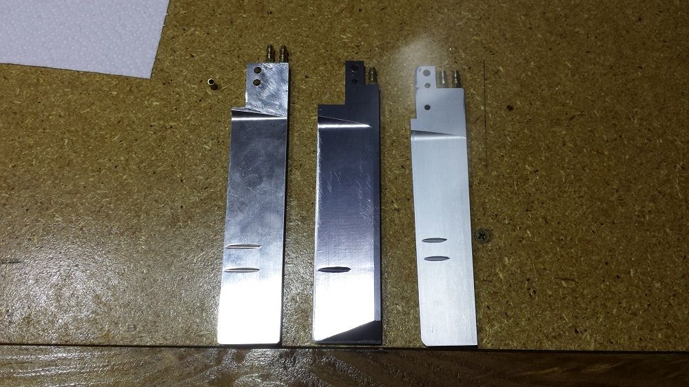

      Yes actually. I found a rudder on my shelf actually that looks like it will fit nicely. Can't be certain - but I think it might be a 6.25 inch dual pickup speedmaster. Steve (OSE) has them, and mine looks notoriously similar. The mounting holes are closer together like in Steve's pic. Stock rudder I measured at 160mm. That Speedmaster one comes in at 158.75mm - so almost the same. Just looking by eye the pickups look deep enough to get the water. Not much modding - if any to fit it so should be easy to test. Gotta get water fittings for mine though before I can test.
      EDIT: Got Photos
      Speedmaster Dual Pickup rudder installed. I had to take off a wisp of thickness to get it fitting in the Zelos 48's mounting bracket. Also, see how the rudders have that indent at the top where the mounting holes are. I just had to file the Speedmaster's downward a little so that indent would fit under the main mounting arm. No biggie. Also the hole for the sacrificial pin on the speedmaster was bigger on mine, so I made a little sleeve for it to take up a little slack.
      Stock rudder in the middle. Speedmaster (modded) to the left with the little sleeve for the sacrificial pin. Generic brand to the right with a hole drilled for the sacrificial pin. Both new rudders *do* actually fit without issue. But the Speedmaster was closest to the dimensions of the stock rudder. Plus you can see the generic brand rudder is an angled edge, not a straight edge like the stock. No tests yet. Will get back to you on that.

        Looks good so far! I'm interested to see how much better the flow will be.

          I think i'm gonna go with the Speedmaster from OSE, I moved my Esc water outlet to the other side of the boat so I can see the water coming out a little better, was having a hard time seeing it before with the other outlet next to it. Now I can see the water shooting out intermittently not steady like the motor outlet. I just need that peace of mind knowing that its getting enough water to that esc. I see IRON-PAWW that your got your strut all the way down, how's that working for you? I'm running my strut about have way down and I think its working better for me as i'm only able to run in rough waters. Looking forward to your test on water flow.

            I put the rudder pickup through the ESC on mine to begin with, and did the motor with the under-hull. Generally - ESC's tend to get hotter. But really, neither got all *that* hot with mine. But I'm just testing to see if a dual pickup rudder will help with temps at all. No harm in trying. Insufferable tweaker...

                              Took mine for a quick test run today with the Speedmaster rudder, 6500Mah SMC lipos, & a little negative as below. Was 10mph slower, but the bounce was very minimal and definitely improved over before :-). The Speedmaster was unsharpened - so I've now fixed that. A little too much negative too I think. I realised I changed too much though for this run so I'll keep everything the same for the next run except the sharpened rudder. Water flow was much improved - but temps were unchanged. Oh well - worth a try. Will do a few more runs and see how it goes.
