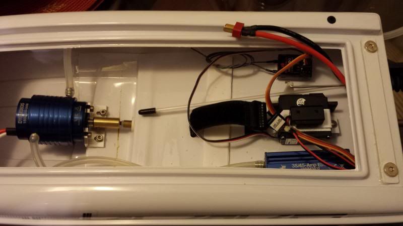

    Since I have a SPC 5000 mAh 2S lipo pack lying around with a deans connector, I decided to change the EC3 connectors on the ESC to a deans connector.
    For those who want to know part numbers, this is the one that I bought:
    Before, with the EC3 connector:
    After, with Deans connector installed:
    I'm still waiting for the Marine grease and Octura x640 prop to arrive before trying it out at a nearby lake.

          I would run 5.5 but that's me.
          Make sure you keep a eye on those connector on the motor to esc,
          And that deans plug for high temps from the amp draw.
          ? ONLY IF THEY WORK

                  I just plan to run a 5000 mah 30c 2S lipo, so I'm just sticking with the stock connectors. Btw, I have read somewhere that using larger connectors (from motor to ESC) creates more resistance. Is this true?

                    For $10.00 try it and see what it does for the setup.
                    We all know that is the first thing to change on a rtr boat,
                    The 5.5 bullets just allow more conductivity for the electricity to flow through the setup a lot better.
                    ? ONLY IF THEY WORK

                        I'm going to run my boat stock first to see how hot will the esc and motor be after a 10 min run.
                        I already have some 5.5 connectors lying around, so I might have to install them sometime next week.

                          Do 2 minutes and check temps and for water in the hull to,
                          Than if all good try 5 minutes and check again.
                          ? ONLY IF THEY WORK

                              With a new boat you always need to check it over real good,
                              Because you never know what your really getting till you run it and than it is to late.
                              Better safe than sorry.
