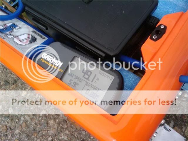

                      I've run 5s on the stock motor and stock esc and gotten 49.1mph and that was a little nuts..
