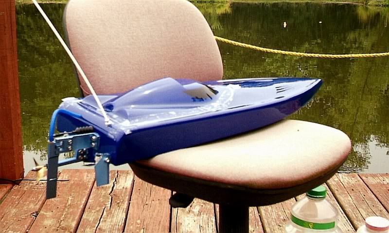

      Justin's new boat, I like it. She was bone dry pro test run. Motor wasnt bad with stock cooling, still would either install a new water pickup or gwt a OSE jacket. She likes my X642, but she comes with a CF45. I had fun.

        Ice329 I was leary about you on Ebay but now I must apologize. You are doing very nice work and I wish I bought the orange one way back.
        You have proven quality prep methods and I am now finishing all mine after 2 runs and water all inside the hull mainly do to the leaking cooling system.
        Aside from all your prep work I also opened up the hole in the motor mount that the motor shaft goes through so that the motor can be removed without the mount if needed.
        I had to use a mini torch to get the set screw thread lock off and some off the motor shaft too.
        I noticed the set screw was not on the flat spot either, that is now fixed also.
        Looking forward to my next run.

          Maybe next time. I wonder if sometimes people worry, thats why I post all pics. That orange one was nice. Those set screws are a PIA.
