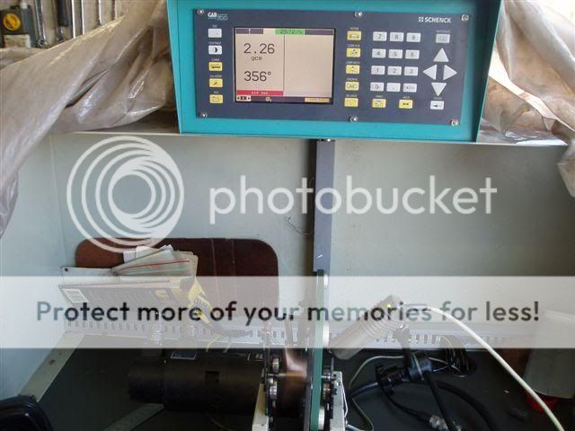

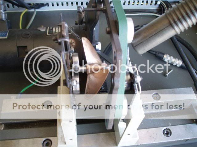

                            Your pretty darn close Tony. Its not just a drive dog that can add to imbalance (set screw size) but the whole rest of the driveline on many levels. I recently got into a banty with Jay about free floating bushings in struts and stingers. What it boils down to is tolerances. The greater the tolerance, the more movement, therefore if only one component of the driveline is not balanced the system as a whole will suffer increased friction and imbalance. It only takes one part of imbalance to ruin the whole shabang. I do have to refrain from pounding my logic into others. I cannot always explain it well enough in words to not appear arguementive. Having said that and not trying to defend myself from past statements. The cards lay where they fall. But to expound upon the OP about prop spinning here is a pretty awesome prop balancer that can do what none of us can do by eye alone. Its a Schenck dynamic balancing system designed to spin turbo impellers up to 17k. Works good for props too!
                              John
                              OK Bro, now I know where to send my props to get balanced ! lol
                              Another thought I've had ( I try not to think too much) is that the in/out/in/out of a surface piercing prop likely causes much deflective vectoring of the rotating mass of the prop/dog/shaft. John, I agree totally that close tolerances are important to avoid premature wear or potential harmful harmonics.
