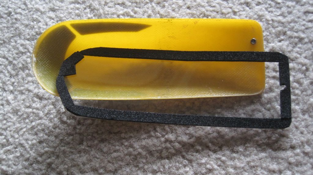

              I think I've found the problems to my overheating. Stock coupler's hole is too large causing wobble\vibration. I've received a lighter aluminum Joysway coupler and will bore it out to fit the larger motor shaft diameter. It's half the weight as well.
              Here's my lexan cowling cover with foam gasket. I still need to seal the seams and epoxy in the bolt as the hole has already cracked:

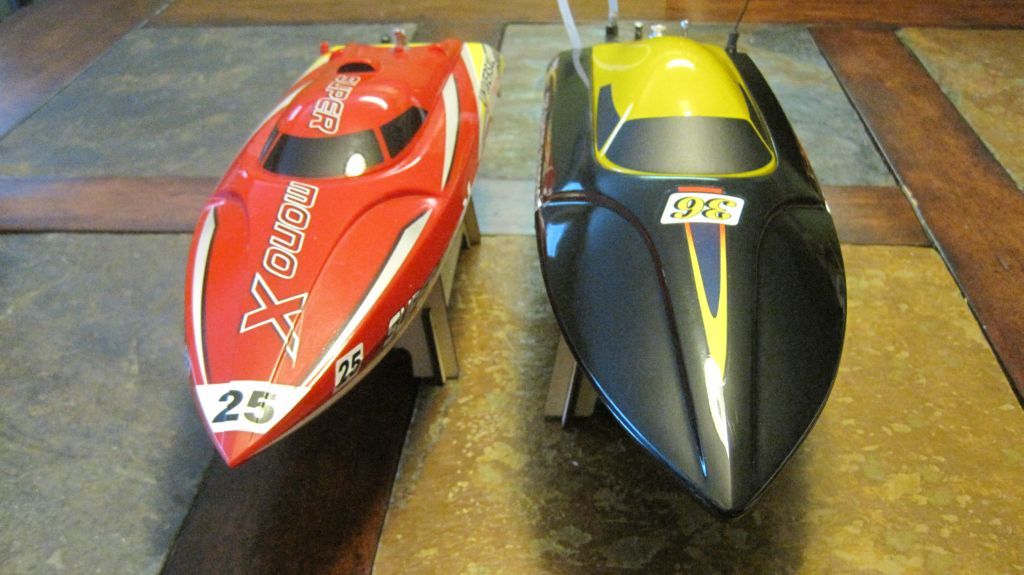

              Warrior vs SuperMonoX:
              What makes the Super Mono X much easier to self right over the Warrior is that the beam is much narrower.
