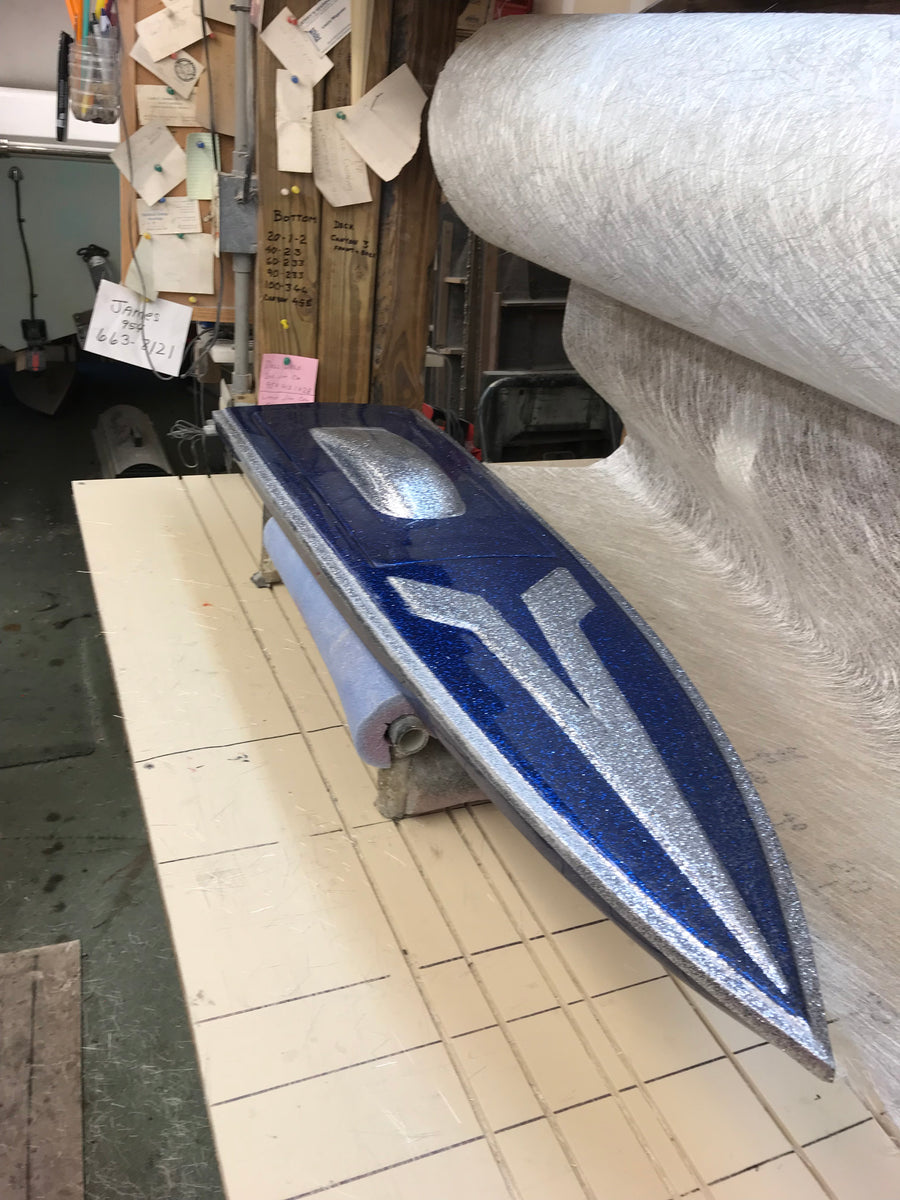

    That would sit nice in a Lazer 40 on 6-8 S
    I ordered the one with the open cockpit.
    Wayne is kinda backed up, but top quality boats and customer service.
