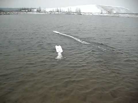

          Here is a Tenshock Electra twin setup 2 x 2200kV and 2 x 6S
              That's cool!
                    To be fair these guys are unlikely to got too hot running in ice cold water.

                      • properchopper
                        • 6968
                        Plus they stay WFO less than 3 seconds at a shot. They are very nicely trimmed, run sweet, and I'd bet their pilots were having a ball
                        That's What it's All About (except for the Hokey Pokey)
