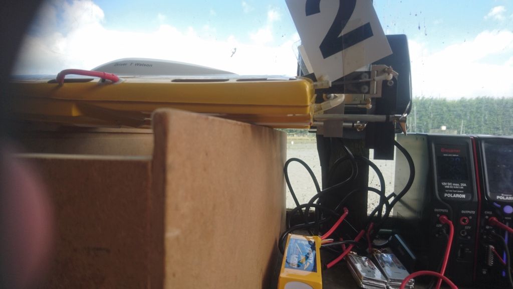

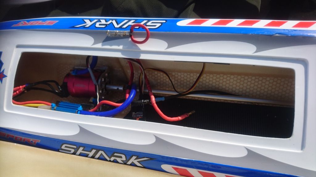

            There was a race last week and I took some pictures of the rear end of well set up monos for you, I was horrified to find out that when I was taking the photos peope were thinking i was working on a mono myself, so I didn't get out a tape measure and angle gauge.

                  Sweet, thanks Paul! Ok, you've convinced me... I'll go vertical.
                  Yes you did tell me, I just haven't had the time to redo the turn fin.
                  Gonna make in as deep as the keel and 2" wide, sound like a good start?
                  Thanks again for the recon pics, and for going under cover as a mono guy.
