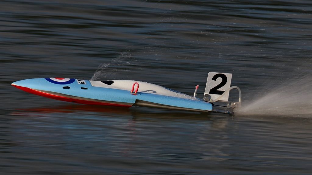

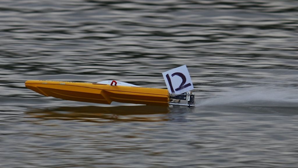

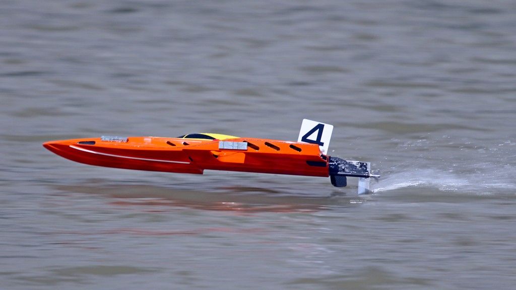

                I will caveat this with telling you that I was a cat guy, and now race riggers, I am not a Mono guy so I don't know the exact and measurements, I have given it a go in the past, but I wasn't too keen and my own stepped race mono was designed back in '08, I have not raced it for years, and it would be hopelessly uncompetitive if I tried to race it now. They are however the most popular classes here, I see them all the time, and the standard is pretty high. My last club had the current Mono2 (4-6s) world champ in it, and my current club has a former world Mono2 champ in it. I can give you generalisms and rules of thumbs, but if you want to know specifics I would have to ask one of the mono guys.
                There is little or no prop depth angle or length tuning, all monos have the motor mounted as low as possible in the step, and the vast majority use a straight alloy, carbon, or alloy and carbon stuffing tube, with a fairly thick for the power (2mm for Mono1 (around 500W) and 2.5mm for mono2 (around 1kw)) piano wire drive, and at least one intermediate bearing in the stuffing tube to reduce the whipping intrinsic to a straight shaft. The prop hub is placed close to the line following the step and transom. If you get the depth or length of the prop wrong you unglue the stuffing tube, oval out the transom hole reglue it and try again. There are exceptions, most notably Rasch makes a carbon fibre angle adjustable stinger that many of his customers use for ease of setup, and his boats have a lot of aero lift so the weight is not as critical. All props are very low lift types and with no ears, usually Tenshock CNC, Graupner Carbon, Dr Prop CNC, TP CNC, not the Octura clones in rages that include them like TP and Doctor Prop.
                Sorry, I don't usually take static shots, so these are the best "shaft" shots I have on my PC, 2 typical stepped mono straight shafts, and the Rasch carbon stinger, all on well set up boats despite the aerobatics in the photos but if I post more typical photos you cant see the shafts. the number plates are all about the same size, that is a Mini Mono, a Mono1 and a Mono2, so although it looks like the step size is getting smaller on the lower pictures, it is fairly consistent, it is just proportianally smaller on the bigger boats.
