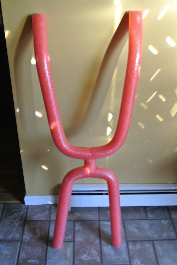

I have used that style recovery also with the Tug. When the boat is flipped it is harder and you try to catch the antenna tub or Hatch latch if your boat has one. Fun noodle set up is easiest and you can make it smaller or larger.Last edited by Newboater; 12-09-2016, 10:25 AM.Comment
how you get that noodle to hold shape?volantex vector pro ,proboat veles 29 , traxxas spartan, hobbyking/tfl pursuit ,ft009 with rescue riggingComment
Simple, heat up with a hot air gun and the pvc becomes very pliable, shape it the way you want and let it cool. That whole set up will set you back about 7 bucks and that includes the fun noodle. Rescued several peoples boat with this set up and it works like a charm.Comment
thanks .i just might have to do that . how many feet of pvc you got in use there ?
i can get a 10 foot piece for like 1.35 ,but cant source any pool noodle this time of year .volantex vector pro ,proboat veles 29 , traxxas spartan, hobbyking/tfl pursuit ,ft009 with rescue riggingComment
It is one 10ft piece, and 2 Tee's and 4 end caps. Usually any pool place has them, they just shove them in the back instead of keeping them out on the floor this time of year. Cut the 10ft piece in half make two half circle bends the size you want. After they cool bend the ends up slightly by reheating the pvc, this rise helps keep the disabled boat captured inside the U shape. The extra little pieces you have left over from trimming down the size are used to connect the two Tee's. Glue together put on fun noodle then the end caps last and your done. Takes about 40mins total.Comment
thanksIt is one 10ft piece, and 2 Tee's and 4 end caps. Usually any pool place has them, they just shove them in the back instead of keeping them out on the floor this time of year. Cut the 10ft piece in half make two half circle bends the size you want. After they cool bend the ends up slightly by reheating the pvc, this rise helps keep the disabled boat captured inside the U shape. The extra little pieces you have left over from trimming down the size are used to connect the two Tee's. Glue together put on fun noodle then the end caps last and your done. Takes about 40mins total.volantex vector pro ,proboat veles 29 , traxxas spartan, hobbyking/tfl pursuit ,ft009 with rescue riggingComment
