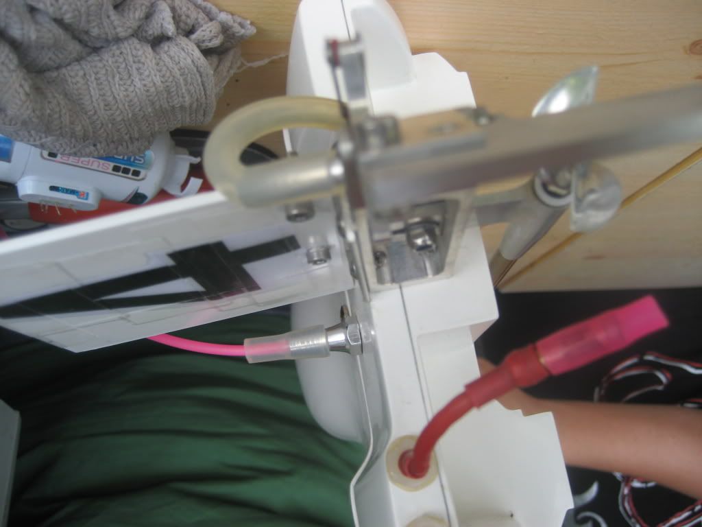

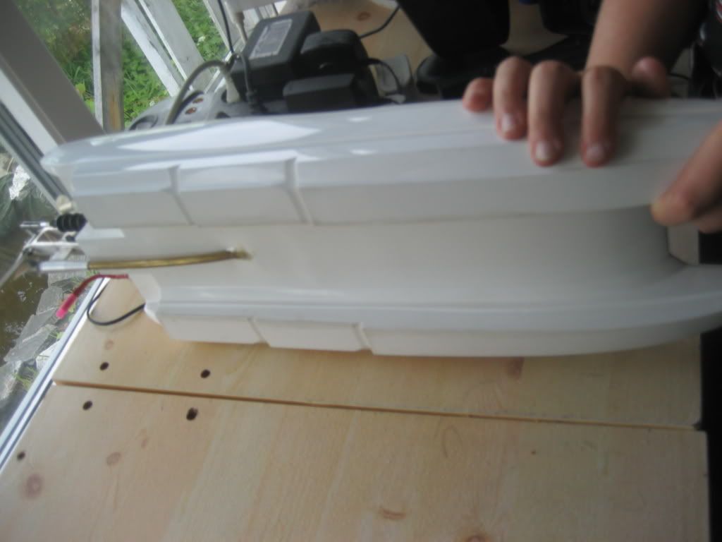

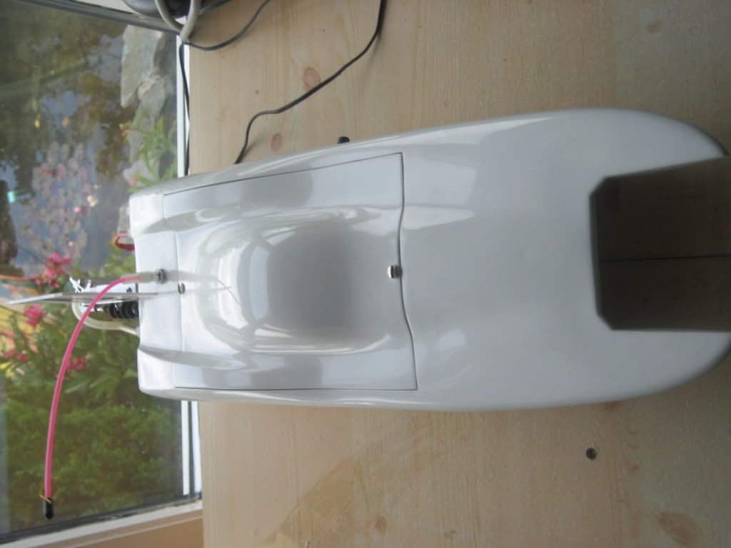

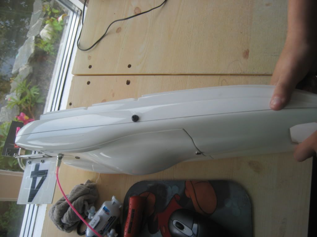

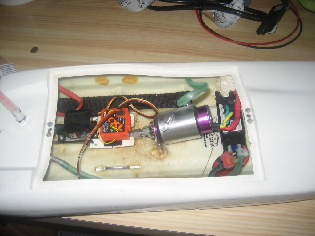

                        here are a few pics.
                        motor feiago 380 8L prop H&M 28mm. 2mm flex onto a 4mm treaded shaft. CG normaly around 34% when batteries are were the water outlet is. you cant se the led on the right side. but it is 115g worth of led ( same type as when you balance your car tires).
                        can post more pics when i get home from work.
