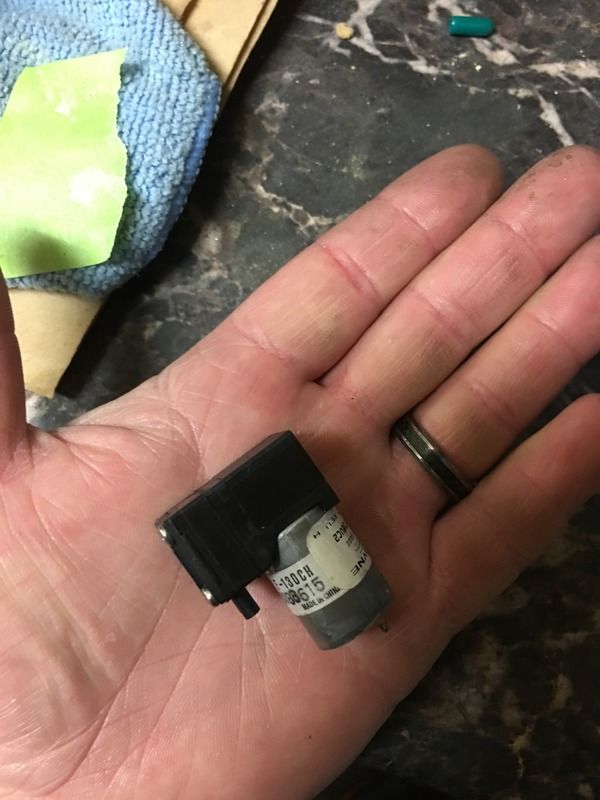

Update. I got the boat for the first test painted and reassembled. I also got one of the pumps in today. Testing Saturday.
This pump is very small but for its size it does very well. It is self priming too. It will shoot a stream about 5-6ft. I also timed it on three different voltages. I used 11oz of water and pumped into another cup.
2s took 1 minute and 23 seconds
3s took 1 minute and 6 seconds
4s took 58 seconds. It did not run warm on 2s or 3s but did run warm on 4s. The extra 8 seconds it dropped off isn't worth it. This is a sensidyne pump btw.

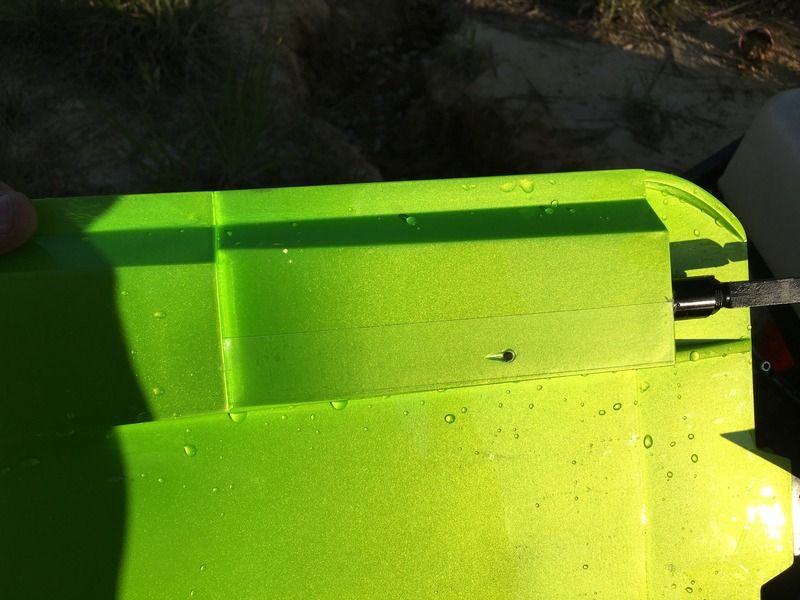

Went did test number one. Definitely did not turn out how I expected. I can't say this is a end all for this question however. Let me say why. First is I was not in contolled laboratory conditions. I made one pass and checked speed. Then I put hatch tape starting behind the step of the middle sponson to the end of the rear sponson. I would say that pretty much eliminated the pickup drag. Also because I was having a slight amount of porpoising I moved the batts up one inch. Because it lost speed when I blocked off the pickups I ran once more with the batteries moved back to the original position. Speed was the same on this run also so I had to rule that out. All three passes were less than 1mph apart. So on to the videos. Here's video one with pickups.

Here's how I blocked them off.

Travis these water pick ups definitevely won't produce measured drag in your experiment but a knife blade rudder will....the speed on my SAW Jae with 4082 2000kv motor on 6S jumped from 85mph to 88mph just swaping the rudder blade.Attached FilesGO FAST AND TURN RIGHT !

Dmitry you re right and this is a custom knife blade laser cut I did 3 years ago...since that only air water pick ups on my saw boats..and yes in hot set ups you will be surprised with the speed's improvement.GO FAST AND TURN RIGHT !
