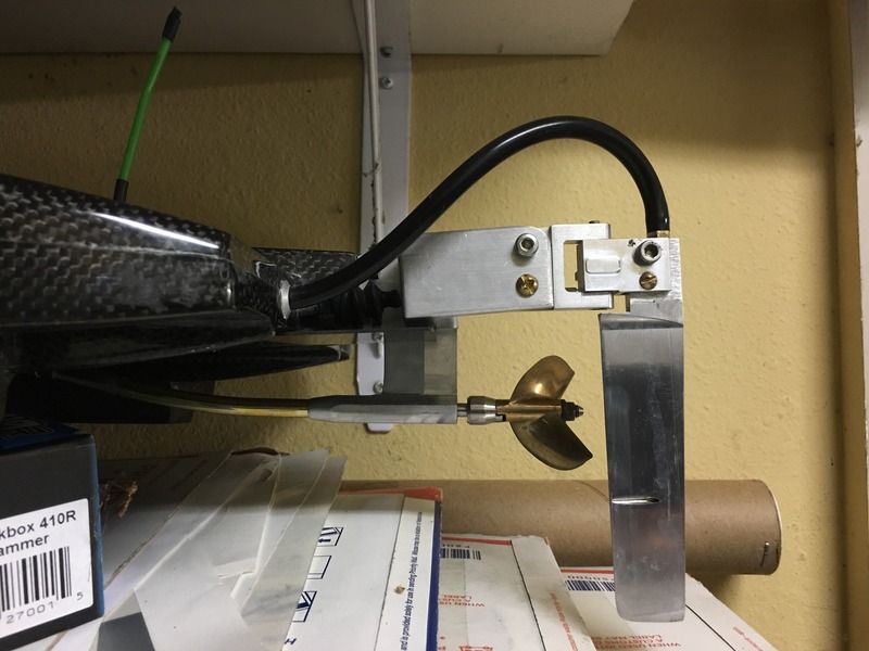

Travis I always run riggers and can tell you that using a knife rudder on my saw nitro and FE boats there is significant difference in speed....I'm curious to see in your boats too .Gill
Water pickup drag testing
32" carbon rivercat single 4s 102mph, 27” mini Rivercat 92mph, kbb34 91mph, jessej micro cat(too fast) wasComment
So if. you want to make a good test try a knife rudder in this catGO FAST AND TURN RIGHT !
www.grsboats.com.brComment
Some of the guys up here in the great white north think out side the box .... well several boxes ! JB weld/epoxy brass tubing down the back of the rudder( clean and ruff both surfaces) with just a hair past the bottom of the rudder or less. worked very well for Marc Andre's p-hydro
Cheers, Jay.Comment
