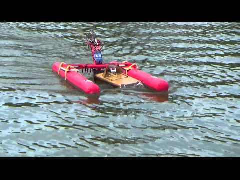

              On the contrary, I have rescued 45" cats no problem. That rig is bigger than it looks. Sponsons are 43" long. Prop is 11". It's has decent speed and maneuvers great. The entire prop/motor assy rotates for really sharp turns and it can reverse as well. The sponsons deflate for easy storage. I really had no idea how it would perform but I have been more than pleasantly surprised.

                Here's a short vid of a rescue

                  The pond where we mainly run tend to get a lot of debris in the summer. Every now and then you get plastic bags caught in props. No problem for an air rig.
