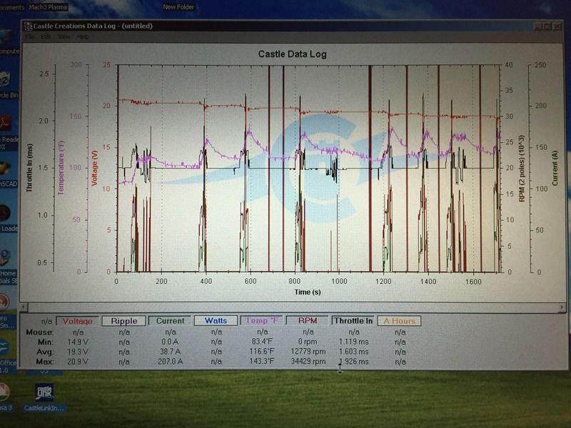

            I dunno man. It's always showed like that on my computer. I looked at it again this morning and tried to expand the screen and make it taller and that's all I could get. It jives tho I think. That was the last passes when the batts were getting below 4v per cell. Last past after the run my checker said the were 3.84-3.85 per cell. So yea, voltage could have dropped. I've got another video I'm going to upload. First pass when batts were fresh. You can hear the rpm difference. And see the difference. Problem is I didn't start the dang gps.
              Originally posted by kevinpratt823
              Sorry, I think I put wrong attachments in last post.
              Fwiw, under load the voltage times kv isn't necessarily the rpms.
              I rest my case lol. Yours is the same thing. Now with a castle log it's different. It will go higher. I do like the castle logging much better than mgm or swordfish
                For comparison here's a case log. I could put that Esc in the boat and log it.
