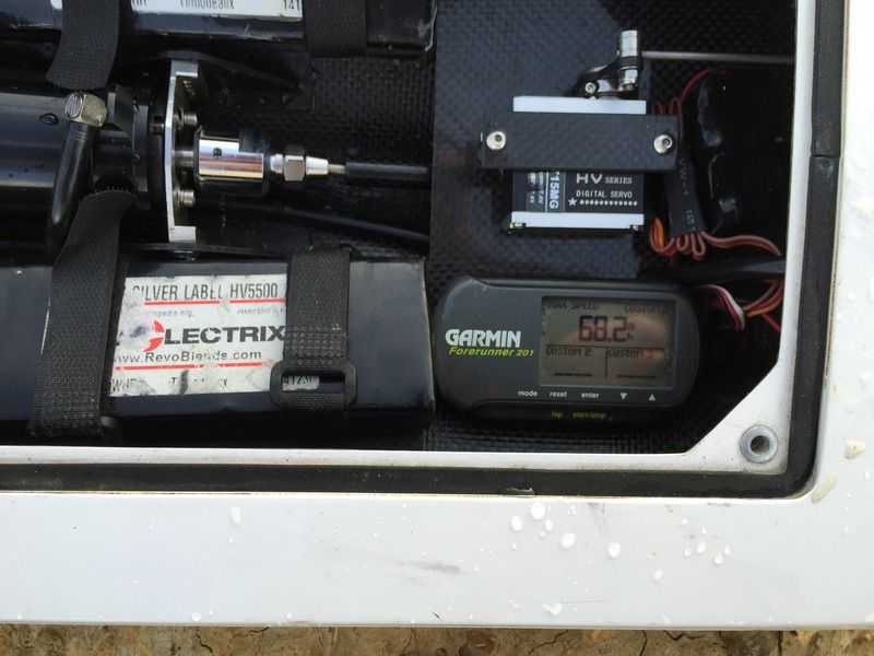

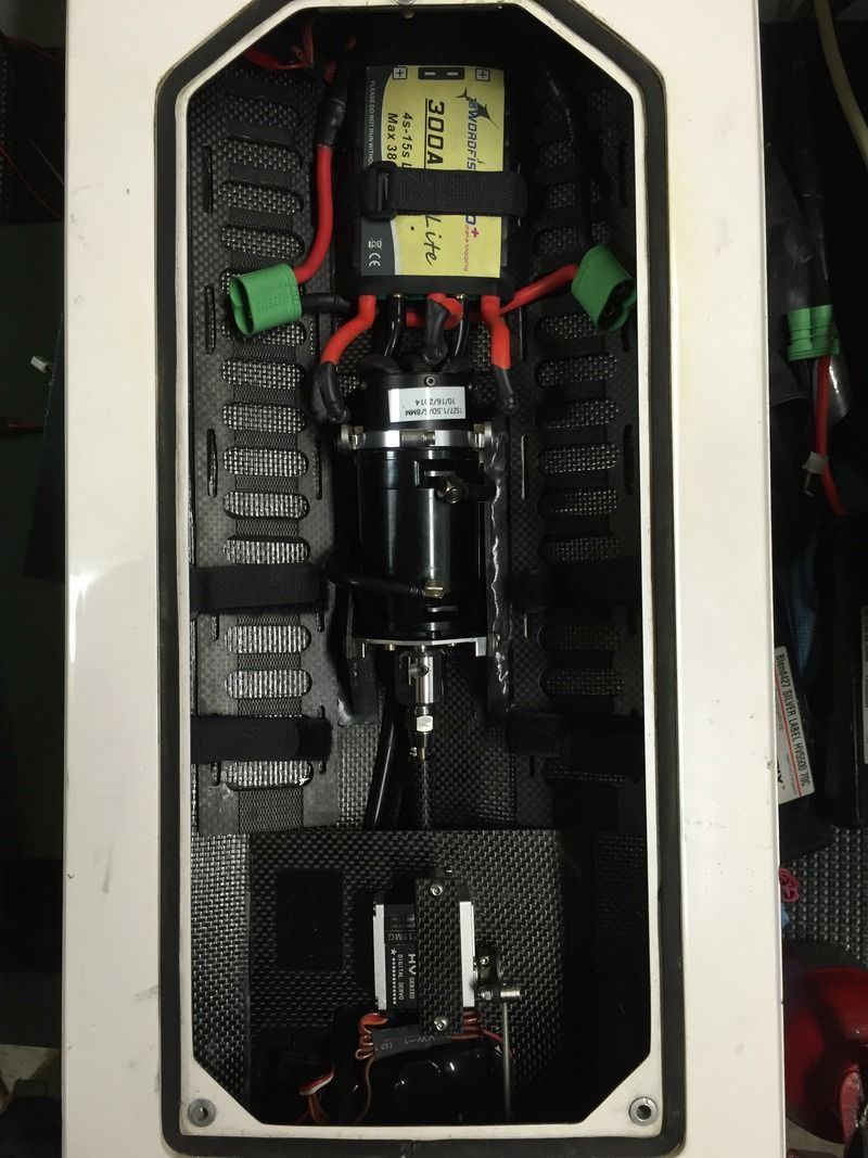

    Most of you guys know that I had a mgm Esc I exploded. Well something happened with the lehner at the same time that caused the kv to change to like 4400kv according to my tester. I already had a sf300 lite to go in it. Then I had a 1527 1500kv as a spare. Last time I ran that 1527 on 6s with an m447 it went 51. Then I did up an abc prop to try out and I was thinking maybe 58-60 mph. When I brought the boat in I was amazed. This is what she looks like with the neu and sf Esc.
    6s 1500kv 48mm 1.5 pitch prop.
    7s
    8s
    Here's the video. I didn't get the 84.7 on on video. I made so many tuning passes my son got tired of videoing.
      Ps... I put unbelievable because the first time I ran this motor it only went 51mph with the same prop that the lehner went 69mph on the same amount of cells.
