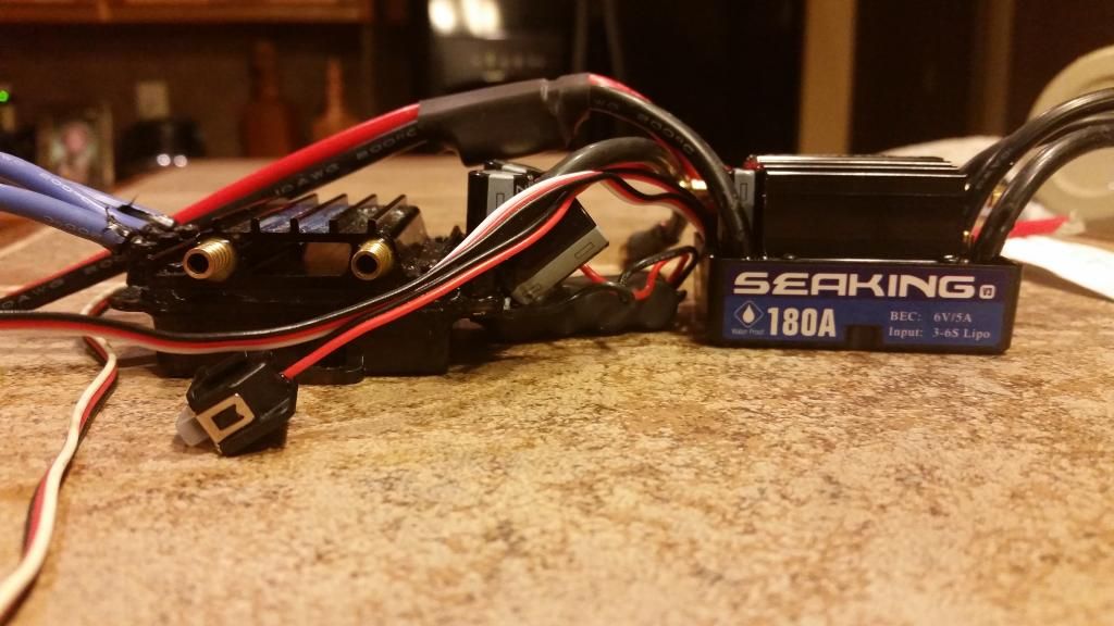

                          I'm have one in my possession at the moment. Things I've noticed (some have not been mentioned)
                          -it's a good bit taller
                          -it's narrower and shorter length
                          -has a waterproofed on/off switch
                          -has a led indicator on it
                          -a good bit heavier
                          -the programming is done through three pins sticking out of it in the motor wire side
                          -has two small caps on the power wires and two small caps on the unit itself. I don't like the fact that you cannot change out the ones on the unit. The are encapsulated in epoxy
                          -the receiver wire is about 1.5 inches shorter than the v2
                          -has four blind holes (maybe 1/8" deep, not good in my opinion) to mount it. The old one has holes like that and ears on the side.
                          -does not have solder posts like the v2 (a big fat negative to me)
                          -the cooling block.....we'll it looks more suited to air cool it, not that the v2 is much better, but the V3 only has one tube going through it. It's offset to one side....I haven't looked where the fets are so I'm not sure if one side would run hotter than the other. Seems possible tho.
                          Overall it does look like a quality built controller. The extra height may be a deal killer in some applications. Comparison pics....

                            Travis tks man....If needed at least you can change the caps on the pwr leads (a good feature). I too am concerned about the single cooling line. I'm looking forward to finding out how they hold up to our kind of running on the edge setups IE: 6S 2200KV etc...or if you can do the 8S trick like I previously told you about (which I dont suggest to anyone who is afraid of the magic smoke gremlin).... DJ

                              i think im going to buy one for myself and make a couple cooling blocks for it like i did on my v2, it will be lower profile too which is a plus.
