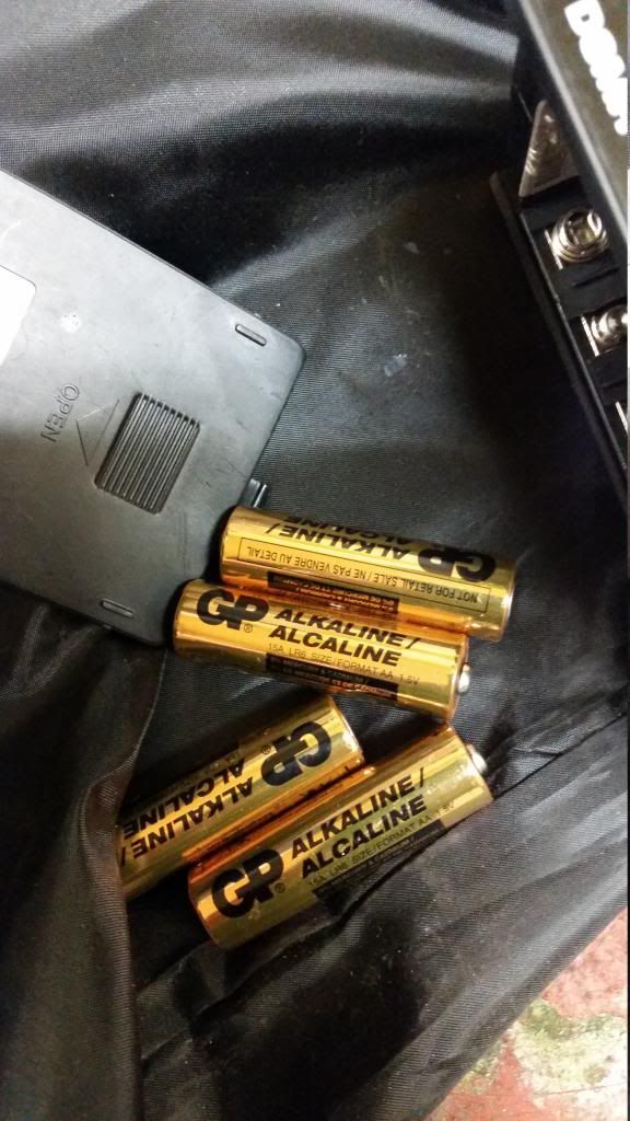

          Well I think one of my kids ripped me off...I'm pretty sure I had Duracells in it.

                        It's the same receiver model number (mr200) but I have one for each boat. Seems like three of the four boats I've had (all cf) had the same type of issue..I have a external bec (different name brands and models) on each one. Something I've failed to mention is each one i just kinda stuffed the secondary antenna up in the empty space by the transome. I am going to route it better and I also had low on voltage, cheapie batts in the transmitter.
