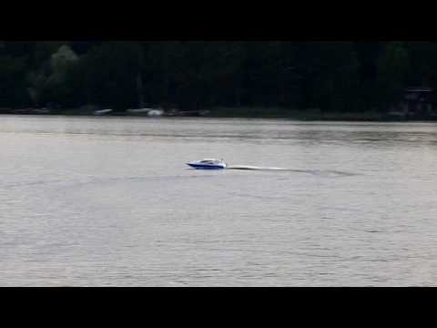

            Hear a build. http://forums.offshoreelectrics.com/...-Princess-boat

              One more.
