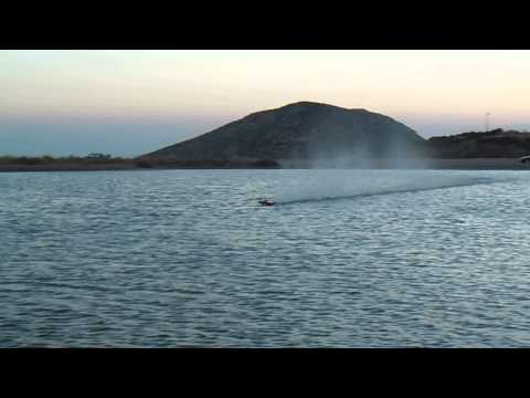

                  here is mine with TP 3640L 2360kv with 4s dinogy and prather 215 prop.
