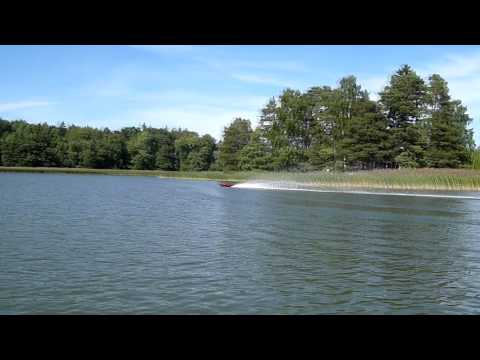

    Hears a big V with outrunners and really no cooling but the motor mounts,
    It run pretty nice for the setup in it and lot of good info for you to read.
    These guys do some very cool off the wall builds and video's.
    http://forums.offshoreelectrics.com/...e-style-build)

          Awesome video lenny!

            Cool as...

              Yes I thought that to.
