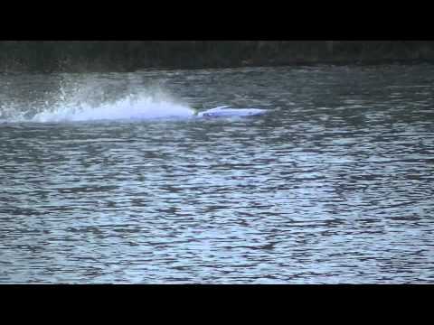

                            Well most props that you will use are 3/16 and a up grade to the shaft would be a .187 x 3/16 shaft,
                            If you want a 6s setup with head room to grow I would go with this set in this Geico.
                            It is this esc , http://www.offshoreelectrics.com/pro...-seaking-130HV
                            With this motor,http://www.hobbyking.com/hobbyking/s..._Inrunner.html
                            And with that esc it leaves lots of room to grow to higher volt setups down the line.
                            Geico with 6s setup and room to grow.
                            This is my modded Mystic running on two 4s packs in parallel and the Keda 4074 2364kv motor is just about max out on 4s.
