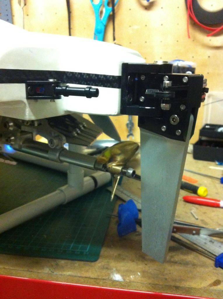

    Just wondered what's the advantage of lengthening / shortening the stinger on a mono? Also is there a recommended distance from prop to rudder or should there be a decent gap between the both my rudder is currently only about 1/4 from the end of the flex

    A lot of people say it helps to have the leading edge of the rudder just in front of the drivedog, out of propwash.

      Sorry should have said its an inline setup, here's a pic
