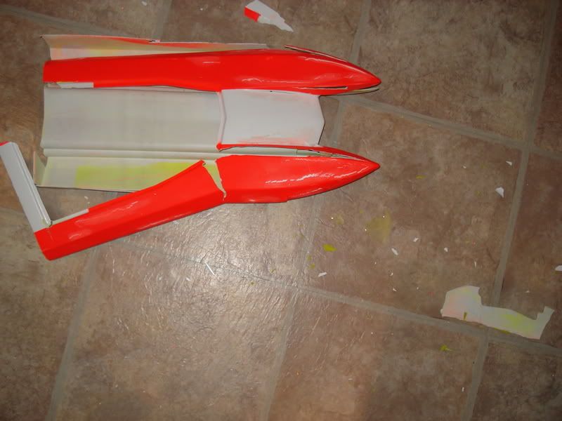

                Doug I will post that picture for will this evening. I don't have it hosted on the bucket any more & am @ work. Will I don't reccomend this method of stress relief but I have to tell you it WORKS. Stay tuned

                              See Will this is what happens when Mr. SJFE has HAD ENOUGH. We get what we have here ..... Like I said before it does help with stress but the with progress on a build.
                              Yes it was stopmed...
