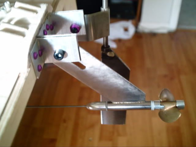

                                #30
                                I use sexy anodised aluminium screws through either a plywood transom or a plywood doubler epoxyed onto a glass transom and held in with aluminium nylock nuts, with a little silicone under the hardware brackets, in the holes and smeared under the heads of the screws just before I nip them down to keep it all watertight.
